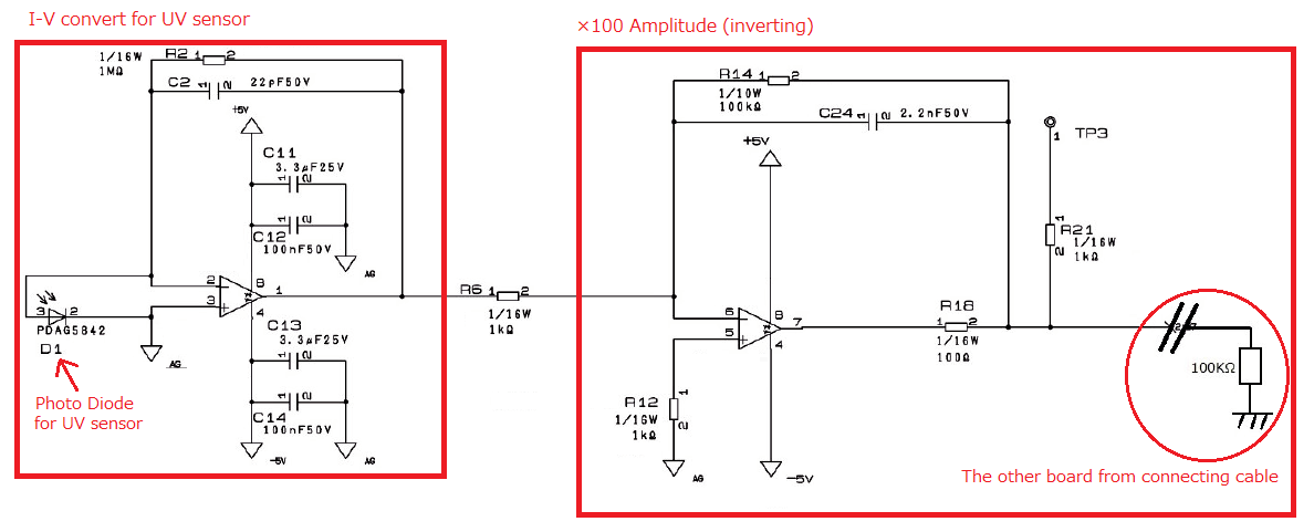

Customer is testing below circuit for UV sensor application.
Sometimes, this circuit is occur abnormal output.
⇒7pin output is near -3.2V~-3.5V, Test Pin 3(TP3) is -0.95V.
If there correction point for below schematic, please let me know.
