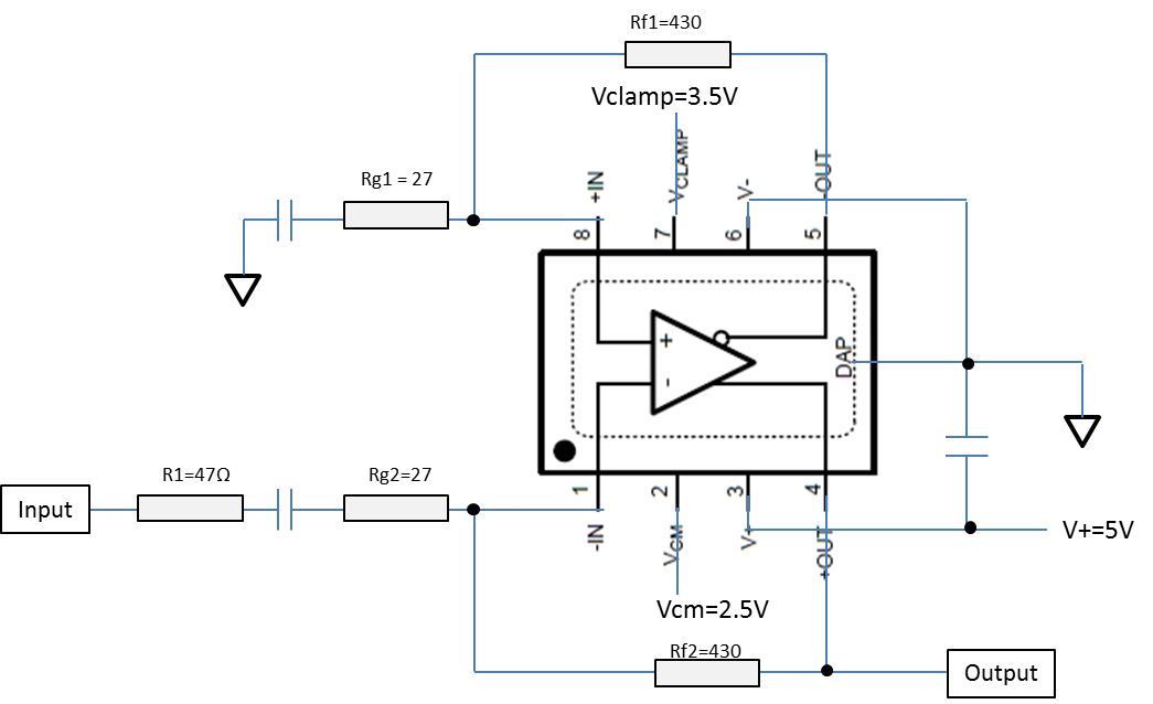

    Regarding to question 2, I add infomation about a circuit the customer is configuring now.
    As shown in this figure, it offers single-end input to single-end output configuration, with 5V single supply.
    Gain  ( single end) : 7.96
    Feedback resistor : Rf = 430ohm
    Source impedance : Rs = 50ohm
    Vclamp=3.5V
    Vcm=2.5V
    Could you please check this configuration and please suggest modification if any?
    BestRegards
  • Hi Na na,
    there are some mistakes in your last scheme. Please have a look at your first scheme again. The - input of LMH6553 sits virtually at signal ground. So, the upper 59R resistor and the upper 255R resistor are in parallel, forming an input impedance of about 50R.
    In order to keep the wiring of LMH6553 symmetric, the feedback loop arround the + input of LMH6553 imitates the impedances seen by the - input. So, the 49.9R resistance in series with the 100n cap imitates the hidden source impedance of the driver, which sits in parallel to the upper 59R resistance.
    Or by other words, the + input and the - input of LMH6553 must see the same impedances to signal ground. In the first schematic this is fullfilled. In your last schematic this is not fullfilled.

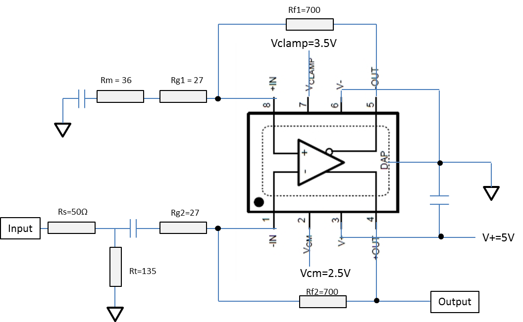

  • Hi Kai
    Thank you for your reply.
    I modified following circuit based on Figure 56.
    I believe this will offer Av=16 (8V/V with single-end out) and it will match for 50ohm system.
    Could you please review it?
    BestRegards
  • Hi Na na,
    I don't think that such a high gain is possible with this chip in a 50R system, because when chosing Rg=50R and omitting Rt, Rf must be much higher than the maximum recommended value (325R).
    Let's see what Rohit means...
    Kai
    I think the circuit you have posted should work with termination resistor Rt = 135-ohms, and Rf = 700-ohms providing an input impedance match of 50-ohms.
    However, one thing I wanted to point out is that due to the input impedance matching, you will lose 0.5V/V at the input. As a result, the total single-ended gain from input to single-ended output will be 4V/V. If the input frequency is not very high and the input interface trace is not very long, then you should be able to reduce the Rs to 10 or 20-ohms, and subsequently change Rm = Rs||Rt. This change will achieve higher gain from input to single-ended output and keep both paths symmetrical. For example, with an Rs = 20-ohms, the Rm will need to be 17.5-ohms.
    Also, if the input and output are single-ended, then is there a reason to choose a fully differential amplifier such as the LMH6553? I think an op-amp can be used here instead and would be a cleaner solution. Is it primarily because of the LMH6553 clamping feature that the device is being considered here?
