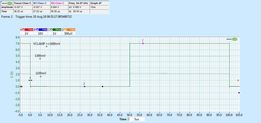

I have observed an unusual recovery from a square wave as the clamp level is reduced.
The following display shows the response to an 875mV (=7V on display) unipolar 5kHz square wave as the VCLAMP level is reduced from 1500mV to 1100mV. The high levels are to the left and right of the display and the centre region is the zero level of the pulse. This is what I would expect, so all OK.
But then I zoom on the zero level and see this:
There is an "undershoot" on the step down to zero with a decay time constant of about 9us. As VCLAMP is reduced from 1500mV to 1100mV the undershoot gets bigger, being about 70mV with VCLAMP at 1100mV. 70mV on the display would correspond to about 9mV on the LMH6553 output.

    The LMH6553 output common mode VCM is 940mV and the square wave goes from 0V to 875mV (single ended) so the output of the LMH6553 will swing from VCM to VCM +/-438mV, or 502mV to 1378mV.
    So setting VCLAMP to anything above 1500mV will not be clamping the signal and we will get the natural response of the signal.
    Here is the output with VCLAMP set to 1600mV, 1300mV and 1100mV. Note that our system has a scaling of x8, so 875mV is shown as 7V. At VCLAMP = 1600mV the signal is not being clamped.
    Then zooming into the bottom of the square wave we can see the effect of the different clamp levels. The bottom trace is with VCLAMP = 1600mV and so is the natural response.
    You can see that with the natural response there is slight peaking (about 12mV which will be 1.5mV on the LMH6553 output), but as the clamp level starts to clamp the signal then there is undershoot. With VCLAMP at 1100mV the undershoot is about 70mV which will be 9mV on the output of the LMH6553. Approx 1% of the signal.

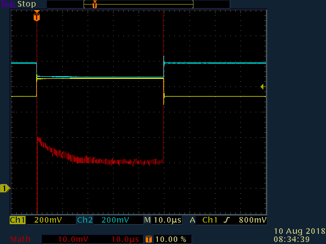

  • Hi Micah,
    A bit more information:
    I connected the outputs of the LMH6553 to my Tek scope. Ch1 = -OUT, Ch2 = +OUT, Math = Ch2-Ch1.
    Here are the signals with VCLAMP = 2500mV, so no signal clamping. The Math is flat, i.e. no undershoot effect. This is the natural response.
    And then I set VCLAMP to1100mV so the signals are clamped, as can be seen by the reduced amplitudes on Ch1 & Ch2. The Math display shows the "undershoot" effect, about 10mV, which decays over the first 20us.
    Hope that sheds some more light on the issue.
