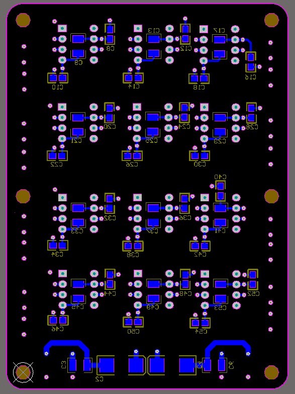

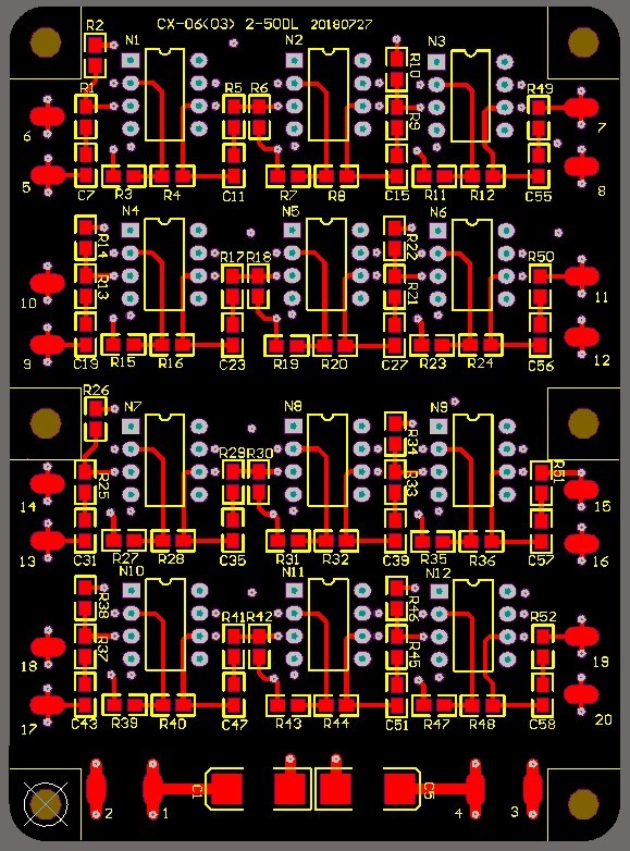

1 The function of the circuit is to amplify the input pulse voltage signal. Each level's magnification is 5.5. The circuit schematic diagram and PCB  is shown below

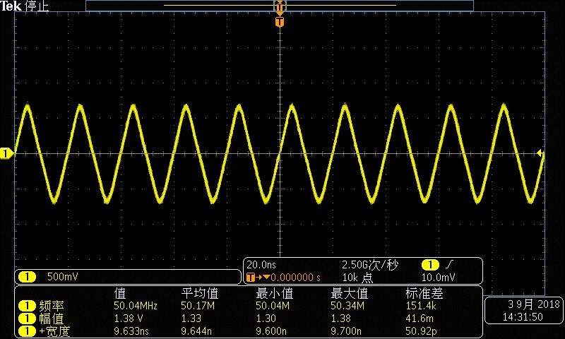

  3. Set the matching impedance at 75 Ohm.The chip does not oscillate and the magnification is normal. The output signal waveform is shown as below and the input signal is 100mV.
  4. Short circuit the two ends of C7.Input signal 25MHz, 10mV to 100 mV.There will be zero drift of op amp. The blue waveform below is the output signal waveform of the input signal amplitude 50mV.
