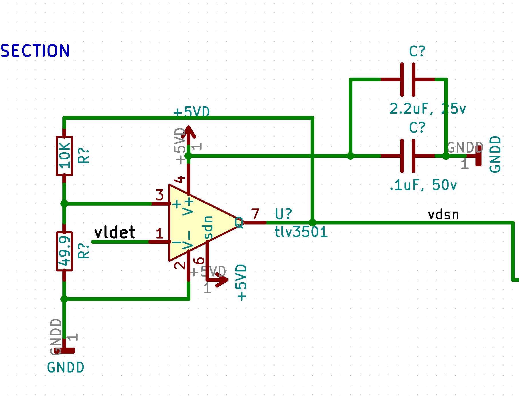

I notice TLV3501 has -.03V possible at the -ve input in a comparator application.
Input in this circuit below  has a sinusoid(vldet)  with min amplitude of 100 mV with max at 200mV
You see any design safety issues with this circuit?
I am looking for fast comparator in a SOT23 pkg & this is the only one I found. I would prefer a split supply in SOT23 pkg but none I found.
Do you know one that would take +/- 5V split in a sot23 pkg & be this fast?
