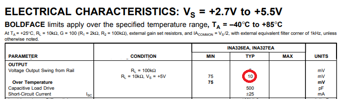

The problem you see comes from the output swing limitation of OPA333 and INA326 - they both can rougly get within 10mV of negative rail but to support your 25nA requirement the outputs would have to be within 2.5mV - see below.
A simplest solution to your problem would be to use a negative charge pump (-0.23V), LM7705, to bias your negative rails of OPA333 and INA326 as shown below.

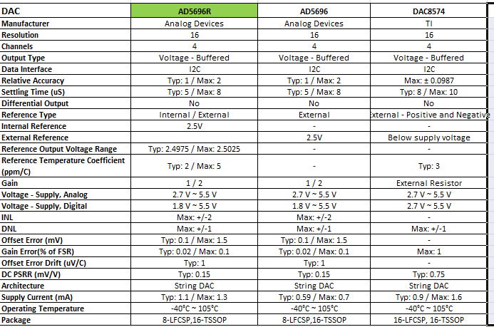

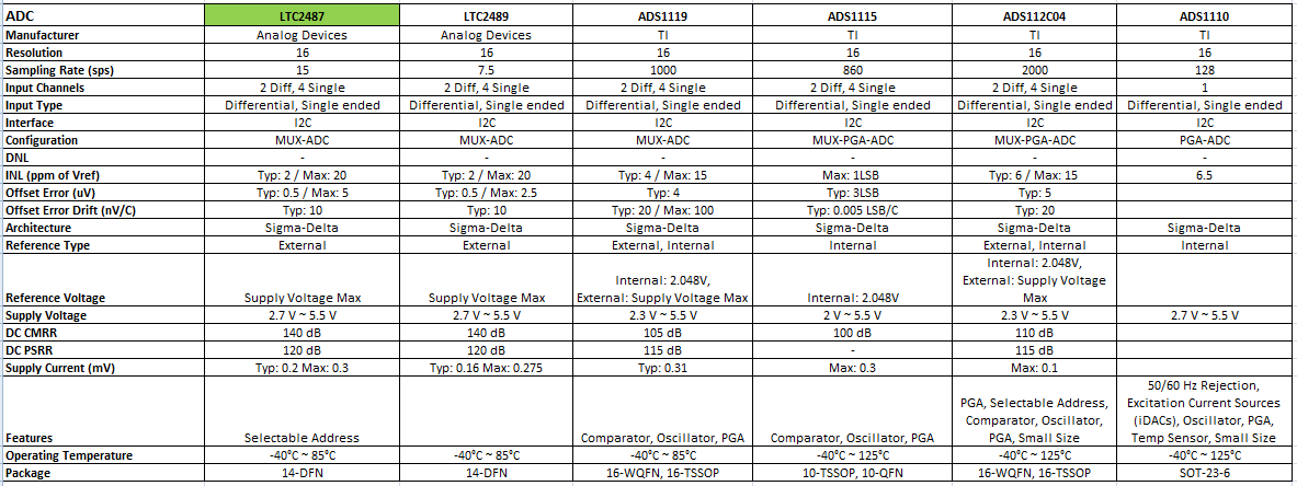

3. I have prepared comparison list for selecting the DAC and ADC. By going through this Analog devices parts are more suited i think or else please suggest the TI parts for this application. Selection Criteria is: Communication Interface: I2C, Channels: 4, Resolution: Min 16 bits, Input Channel type: Single Ended

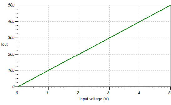

This would translate Vin input range from 0 to 2.5V into 0 to 50uA output current - see below.
Another way would be to leave the circuit unchanged with the exception of increase in the supply voltage to 5.5V - see below.
This would translate Vin input range from 0 to 5V into 0 to 50uA output current - see below.

Sivakumar,
