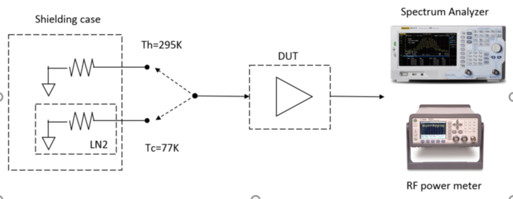

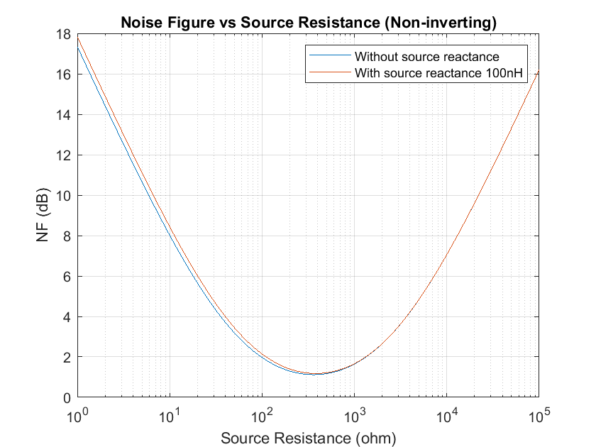

  • I am using Y-factor approach to calculate NF. The experiment diagram is attached. Typically, I used two 50 ohm resistors placed at room temperature and liquid nitrogen. Then, I can calculate Y value by measuring two noise floor level with spectrum analyzer HP4395A. With two known temperature and Y value, I am able to calculate noise figure of the DUT. There are cables between DUT and the resistors, but this can be remove by calculating loss of cable (RG58). The output of the DUT is connected directly to spectrum analyzer. With this setup, the overall NF across different frequencies, e.g. 30 mhz, 50mhz, 80 mhz, 200 mhz, presents unstable for unterminated case, but not for terminated case. I do realize that this could be due to impedance not matched at input of the DUT. Thus, my approach may not be correct. So I'd like to know that if the NF curve (unterminated case) in Figure 58 is a simulated NF curve or a real measurement? If it is a real measurement, then I'd like to know that the experiment setup? If it is a simulated curve, then I think it should correspond to my simulation shown in the attached file.

    We use a noise source (I believe it's diode based) along with a spectrum analyzer to measure the noise figure for both the terminated and unterminated cases. I can get you the exact model number if you are interested.
    How long are the cables between your resistors and the DUT? I'm wondering if the unterminated connection could be causing reflection issues that might show up as an unstable measurement.
