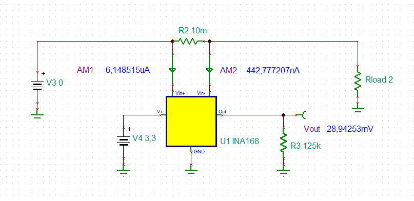

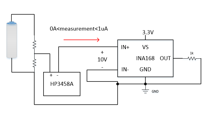

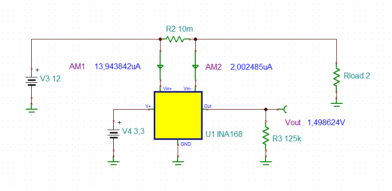

is the bias current of the INA168 always sinked into the device (in datasheet as positive), or is it possible that e.g. at low VCM also a current is sources by the IC?
Thanks' Patrick for the quick reply.
I did't see it source a current, but in our application in is possible that the VCM is close to 0V - below the VCM spec.
And I wonder, if in such a case it is possible that the IC sources a bias current when supplied with e.g. 3V3?
