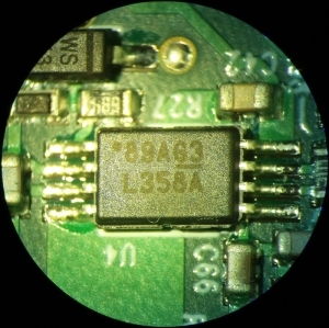

Because of problems in functional testing and checking assembly I have seen there is a different device marking on LM358A.
In production lot 1  we did not have such functional testing problems.
Below you see the device marking of lot 1 (with TI label) and lot 2 (without label) and the reel label from production lot 2.
Device marking lot 1:
Device marking lot 2:
Reel label of lot 2:
Please could you check if these amplifiers from lot 2 are really origin ware from TI.
Thanking you in anticipation.
Stefan
  • Hi Stefan,
    were the LM358A purchased from an authorized TI's distributor?
    What are the functional testing problems?
    Kai

  • Stefan,
    Both device symbols are correct based on assembly site used. The timing differences are likely based on capacitance value and the remaining voltage charge from the previous power on.
