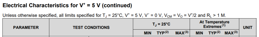

1. What is the Maximum short circuit current on the output, when using a +5 volt rail

    The LMC6482 datasheet lists the short circuit current for V+ = 5 V as follows:
    It can be seen that the Isc is package and temperature dependent. A maximum isn't specified in the datasheet; therefore, we cannot provide a maximum. What can be said is that for a typical CMOS output stage design is the maximum Isc will decrease with increased Tj temperature, and will increase with decreased Tj temperature. The output current is self limiting because of the saturation resistance of the CMOS output transistors. A rough estimation of the high end Isc can be obtained by adding the delta between the typical and minimum, to the typical value.
