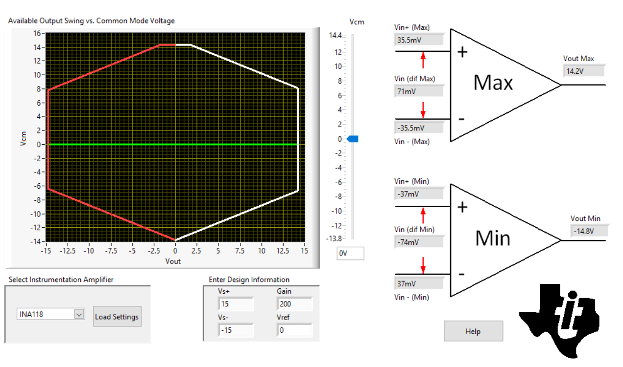

    Thanks for your post. Can you please share with me the supply voltages, ref voltage, input signal, and gain? These parameters will help us diagnose the problem. Based on your description, I am assuming this is a common mode issue. You may use our INA common mode calculator to determine what voltage ranges result in linear operation. The calculator can be downloaded here: http://www.ti.com/tool/INA-CMV-CALC
    For example, for an INA118 with +/-15V supplies, vref = 0V, and gain = 1, your vout min is -14.8V and your vout max is +14.2V

    Thank you for your reply. Based on the VCM calculator, it looks like you're operating in linear conditions. Can you share with me a schematic? You can download the model from ti.com and build this in TINA SPICE.

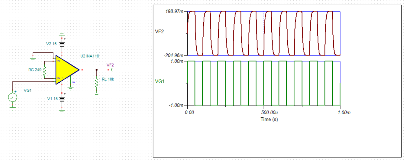

    When i operate with 50 gain then also it gives same problem sinusoidal output pulse. Please find attached Circuit Diagram.
    Output Series cap used for offset removing.Suggest me a solution of Linear output with 200 gain with null offset(min offset).
    Send a Circuit Diagram with Circuit Connection for Solution.

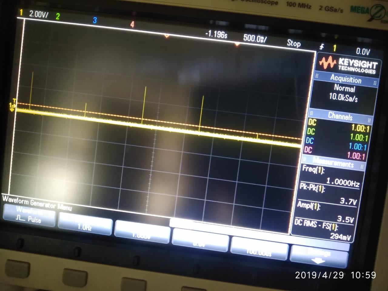

    Thank you for sharing the circuit with me. If I'm reading your input signal correctly, it's a square wave with a 100µs pulse width and a period of 250ms. 100µs pulse width would indeed correlate to a 10k samples/second measurement rate but that's only assuming that the it's perfectly coherent. Try zooming in on your scope, increase the sampling speed to >10k (100k would probably to the trick).

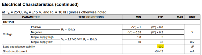

    Another suspicion would be the cap load at the output of the INA118. You have a 1µF capacitor hanging off the output. The datasheet parameters specify capacitance up to 100pF for stability.
    Try these and let me know.
    -Tamara Alani
  • i tested circuit with 22pf load capacitance but problem still continue.

    The reason your square wave input results in a sinusoidal output is because the INA is bandwidth limited. At gains of 50 or 200, when you compound this low bandwidth INA with the OPT101, the -3dB roll-off frequency gets pulled back significantly causing this distortion.
    I have 2 recommendations for you.
    1. You may replace the INA118 with an INA which has a higher bandwidth. You may take a look at the INA818.
    2. You may replace the INA118 with an Op Amp with higher bandwidth with gain of 200 since you're not using the differential inputs of the INA. You may take a look at the OPA192
    -Tamara Alani
