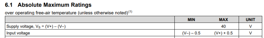

    1. differential mode input voltage range (V);

    4. max acceptable voltage for input pin (V);

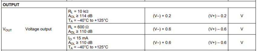

    5. max acceptable voltage for output pin (V).

      1. differential mode input voltage range (V); - See Input Voltage in table 6.1.

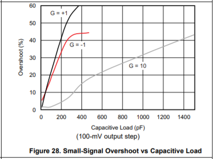

        3. output capacitive load ability (pF);
    Fig. 28 on Pg. 18 provides the complete Cload information.
    See question no. 1.
    The output pin normally sources/sinks current to the output load and the output voltage will be at a specific level determined by the input voltage and the closed-loop gain setting. The output pin does not usually have an external voltage applied to the pin. There is the danger that if the output is assuming the correct output voltage level and an external voltage is applied directly to the output pins, then there is the risk that the output transistors could be forced into over-voltage/over-current conditions where they would be damaged.
    Under normal operating conditions the output pin can swing close to the supply rails as shown in the Electrical Characteristics table:
