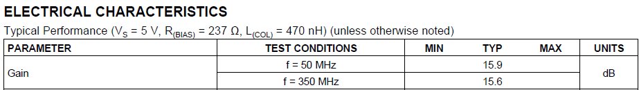

Though the datasheet specifies typical gain as follows, my customer would like to know minimum and maximum gain at f = 130MHz.
Could you provide those numbers, please?

Hello Kazuhiko,
We do not have the min/max specs, however the customer can use figure 2 & table 1 to estimate the gain at 130MHz.

Hassan,
Thank you for your response.
Even TI does not specify min/max gain, my customer would like to know around how much variations must be consider.
From characterization data or rule of thumb, roughly +/- how much dB variation the customer should consider?
K.Hirano
Hello Kazuhiko,
I would say that the gain variation is more likely to come as a result of passive device tolerances. You can see the effect of changing Rbias in figure 6 of the datasheet.
