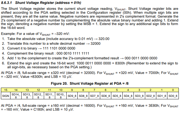

    We are facing another problem while measuring the current for detection of direction of current.. Our electronics is connected to a battery where the  battery will be charged & discharged . Using INA 220 how the values of INA can be used for detecting the change in direction.
  • Hey Shekhar,
    You will use the sign bit (bit 15) of the shunt voltage register to determine the direction of the current. See section 8.6.3.1 of the datasheet.
    Remember that Vshunt = (V_IN+) - (V_IN-). So if IN+ is closer to the battery, then negative Vshunt means the current is flowing into the batter for charging.
    Hope this helps.
