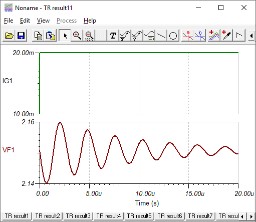

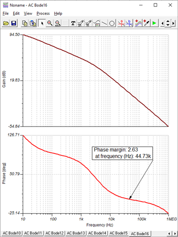

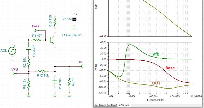

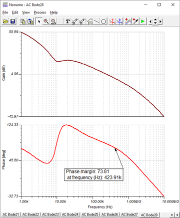

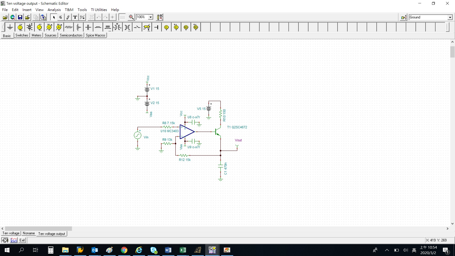

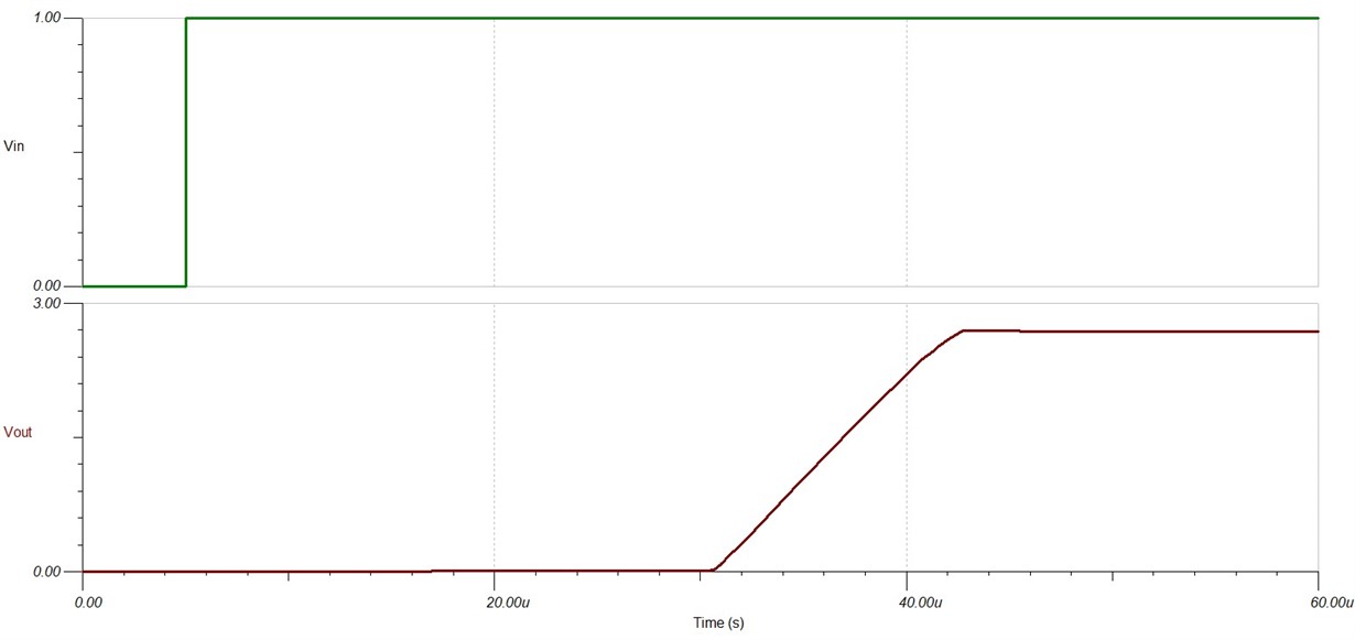

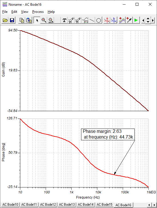

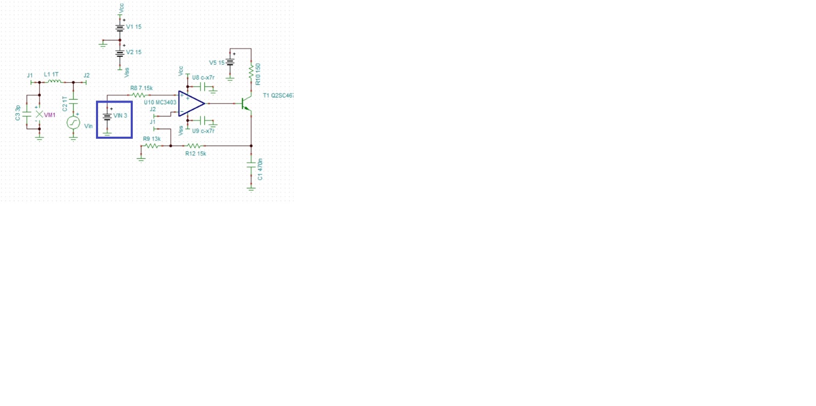

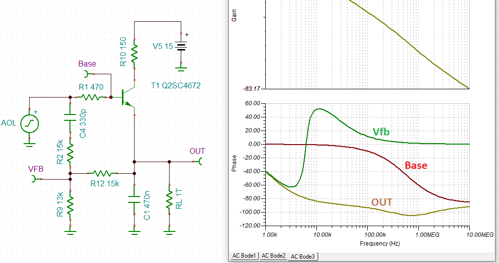

Hi Sir
1.How to sim Loop-Gain below circuit ?
2.How to analysis the stability of this circuit ?
3.For OP output in not allow drive big capacitance, bTen voltage output.TSCut is there still a problem with the transistor(NPN) output?
Circuit concept is Vin=5V then Vout is 10.5V for high power.
