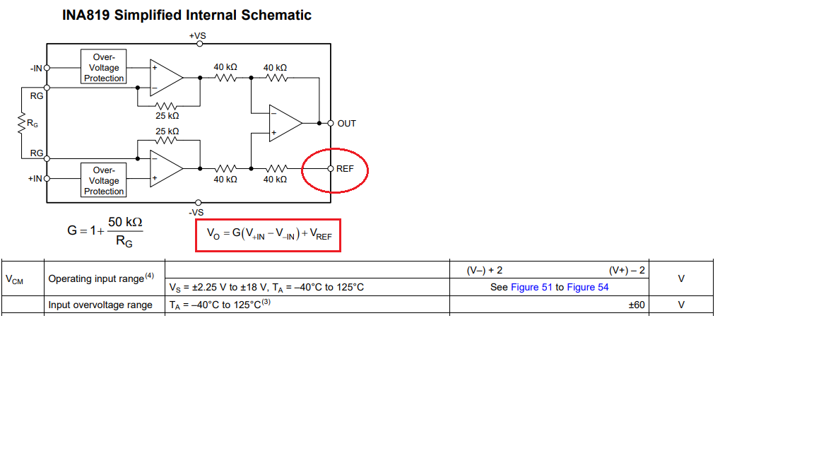

my customer has issues with the model for INA819. The model does not provide expected output if the model is supplied with a single supply. (For example: 5V DC)
The datasheet mentioned the device is capable of operating at single supply voltage.
Could you please check and clarify if it is just the limitation of the model!
