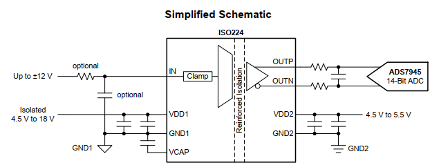

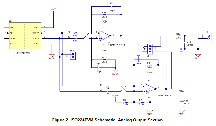

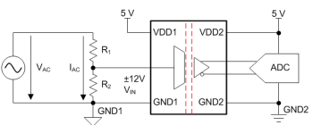

I want to measure 220V 50hz mains voltage. I want to use ISO224 Reinforced Isolated Amplifier with ADS8586S bipolar input ADC. However I am not sure ISO224 can drive ADS8586S directly (with RC filtering ISO224 output ).
Is it a good idea to use an opamp at the output of ISO224, to convert differential signal to single ended, and connect signal ended signal to ADC?
