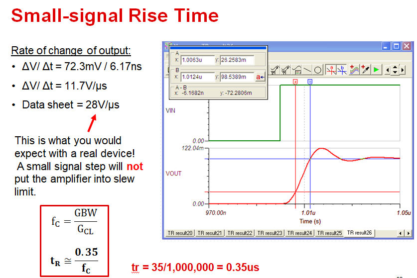

  • Hi Hari,
    I see what's happening here.
    Your circuit response is limited by a small-signal rise time (a small-signal “slew rate”).  Since the input signal is very fast (1ns), according to small signal rise time formula, the output cannot settle faster than 350ns and that is what creates this "reduction" / "distortion".  But this is not a true distortion because we cannot expect 1ns (1GHz) transition at the output in part with 4MHz bandwidth.  In many respects, this phenomenon is similar to slew induced distortion for large input signals caused by full-power bandwidth limitation.
    You can learn more about slew rate in this training video: https://training.ti.com/ti-precision-labs-op-amps-slew-rate-introduction?context=1139747-1139745-14685-1138801-13228
    There are 3 videos in the series that you might find helpful.
