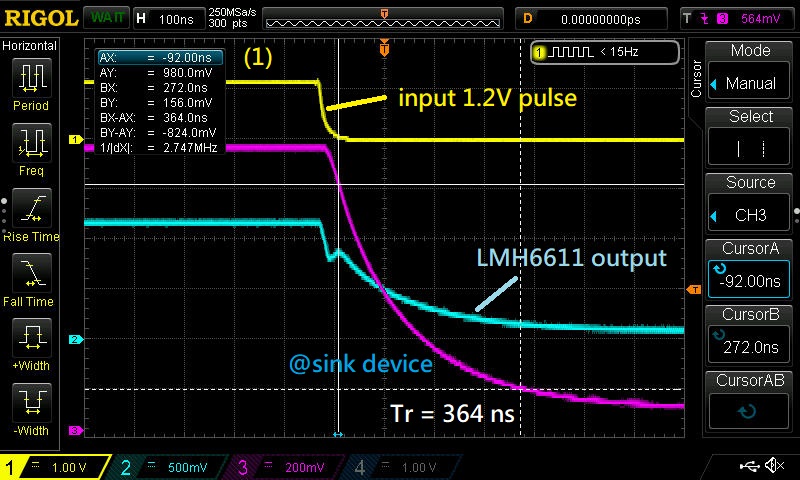

We are driving the Op-amp LMH6611 by an open-drain buffer SN74LVC2G07 (waveform below). The 3.3V input to SN74LVC2G07 is shown in channel 2 and the 1.2V output from LMH6611 is shown in the channel 1. The swing of LMH6611 output (CH2) sometimes does not reach 1.2V.
(Question) Is 3.3K ohm a proper resistance on R133 in this application? Is there any other possible reason why the sawing does not reach 1.2V?

    I modified the circuit. Here are the modified schematics and waveform: change R133 to 1K, remove C54 and change R156 to 56 ohm.
    (Question) why this a GND bounce-up about 30~50mV, around 200us after the start of transmission?

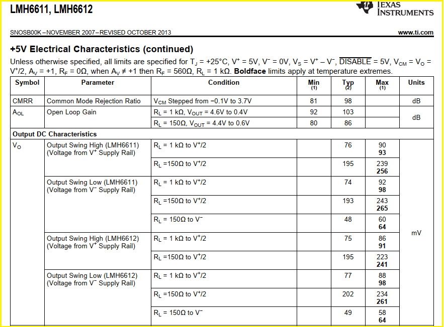

    On the other hand, I measured the swing on the destination device across the USB cable. The offset is always present on the destination. I am wondering if this offset could come from the "Output Swing Low" voltage specified on page 6 of datasheet. One question about the condition of Output Swing Low voltage: I use 56ohm for RL (R156 in my schematics). What does "RL=1K Ohm to V+/2" refer to?

    Yes, of course, what you observe can be the output low saturation voltage:
    In the table "RL" stands for the load resistance, that what you connect to the right side of your 56R resistor. But to show the performance as if the OPAmp would be powered by a bipolar supply voltage, "RL" connects to middsupply ("V+ / 2") and not signal ground.

    (1)If the 30mV GND bounce-up is coming from "output swing low" voltage, do that imply using -30mV at V- pin (pin2) instead of GND is the only resolution?
    (2) Another characteristic Linear Output Current (Iout) at page 6 of LMH6611: what does the condition "V+/2" mean?
    (3) I would like use as small resistance on the output pull-up resistor (R133) of SN74LVC2G07 (U52A) as possible to improve the slew rate. The datasheet, page 4, shows IoL (Low-level output current) 32 mA maximum for VCC=4.5V. Does IoL of 32mA max imply that  the smallest resistance for 1.2V pull-up is roughly (1.2V/32mA) 37.5 ohm?

    yes, a small negative supply voltage would be necessary to compensate for the output low saturation voltage of LMH6611. The LM7705 could be used for this task.

    Voltage divider you suggested earlier seems a good option. I use two sets of voltage divider to convert 3.3V pulses to 1.2V pulses and send them to LMH6611 (pin U55.3). Two sets of voltage dividers lead to almost the same results in the output transition time (pin U55.1) even the input transition gets much shorter. The transition time on the LMH6611 output is around 364~366 ns. Is there any way to make the transition shorter?

    There is certain requirement of eye opening on this CC signal, so I try in improve the slew rate of this signal. The datasheet of LMH661 shows slew rate of 330 V/us for 2V step on the page 3, while it takes 364 ~ 366 ns for a transition of 824 mV (960 - 154) in my circuit above. Is there any way to improve the slew rate?

    Here I intend to improve the slew rate of LMH6611 output (pin 3) when it drives the CC line to the Sink device. As captioned in previous post, the waveform of channel 1 on the oscilloscope is the input to LMH6611 (pin 1).  In the 2nd waveform snapshot in previous port, the transition time of input to LMH6611 pin 1 is around 10ns while the transition time of output from LMH6611 pin 3 is more than 300 ns. The transition of LMH6611 output is the time I intend to reduce.

    I show the equivalent circuit below. The waveforms captured in pin3 of U55, pin1 of U55 and at the ADC of sink device are shown earlier. The slew rate of LMH661 output (pin1 of U55, HC2 waveform) is much smaller than the spec value. How could I improve the output slew rate? Or should use a different op-amp?
    This is a compliance test case we need to pass with this circuit. Please suggest ways to improve the transition times. Thanks!

    The LMH6611 isn't being limited by slew rate here, the plot looks more like an RC response... Recommending a different amplifier wouldn't be helpful without finding the cause of the issue first. Outside of disconnecting the sink device, can you confirm the issue isn't a result of overload as well? You can do this by adding some bias to your input or by adding a small negative supply to the the LMH6611.
