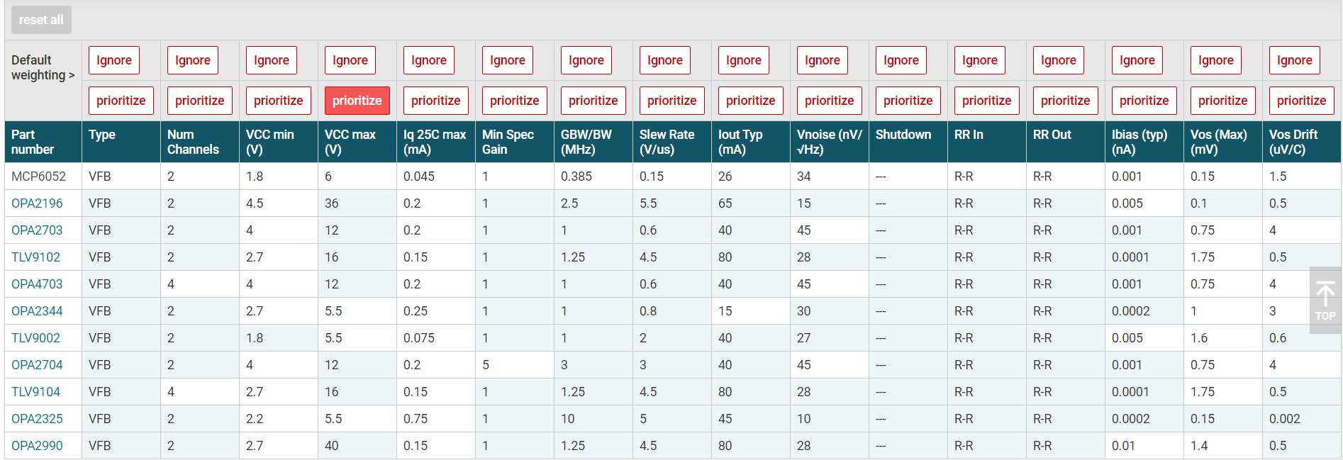

do you have any TI sugesstion to replace MCP6052?
Hi Alex,
The LM358 and MCP6052 are quite different parts in terms of specifications. I'm assuming you are looking for something closer to the MCP6052 than the LM358. I am looping in the precision amplifier team to help you select an appropriate part.
Daniel
Hi Alex,
I did the op amp cross reference search on our site, here are the search results.
https://www.ti.com/amplifier-circuit/op-amps/cross-reference.html?keyMatch=CROSS%20REFERENCE%20OP%20AMP&tisearch=Search-EN-everything
Please let us know if you need further assistant.
Raymond
