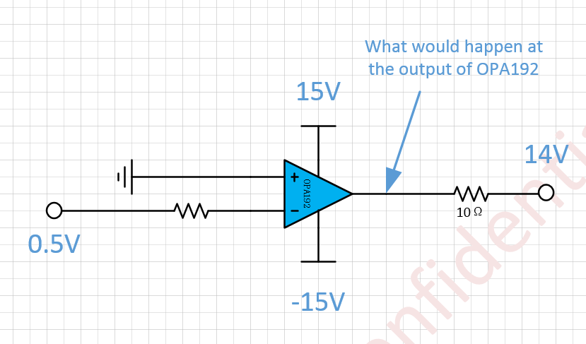

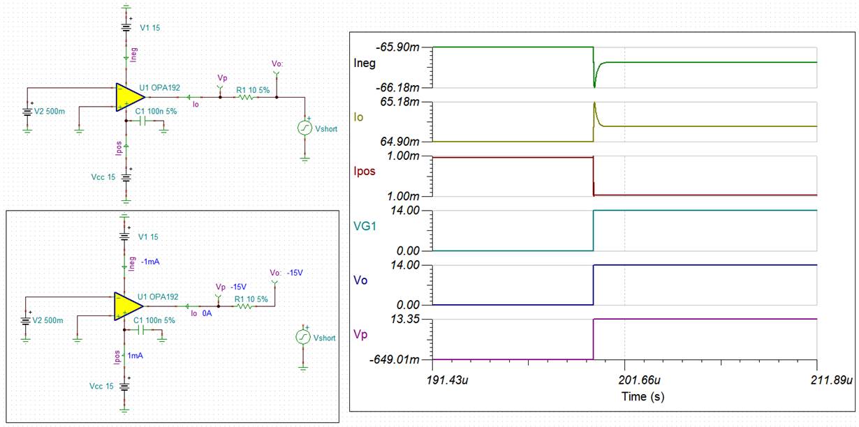

Hi Colleague,
In our customer current scenario, there will be a 14V in OPA192 output in some special time.
So the customer wants to confirm:
1. Whether OPA192 will be damaged?
2. If OPA192 will be damaged, how to add a protection circuit to protect?
3. If we could add a protection circuit, how fast does the protection need to be?
Thanks a lot!
