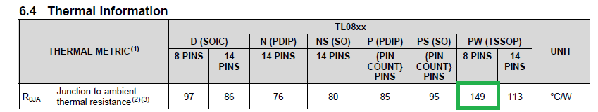

The RθJA thermal information for TL082IPWR is not in it's datasheet. I want to use it to calculate safe temperature, maximum allowable power dissipation and JC. Can someone at TI provide that information?

Actually I want to know the RθJC instead of the RθJA.

RθJC is a nearly useless parameter because very little heat flows from package top to the air.
Semiconductor and IC Package Thermal Metrics (Rev. C)
Nevertheless I will post all the results from the model once it is complete.

TL082IPWR Model complete
Theta JC: 43.0 C/W
Theta JB: 93.6 C/W
Psi JT: 2.8 C/W
Psi JB: 91.2 C/W
