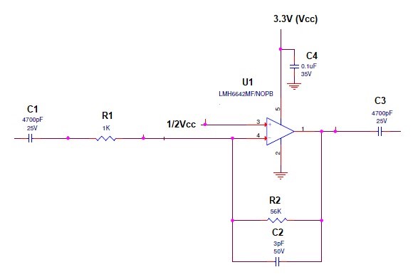

LMH6642: Does TI has a similar amp as LMH6642MF with GBWP~100MHz?
Part Number: LMH6642
Dear Sir/Madam,
I am using LMH6642MF/NOPB as an inverting amplifier with gain = 56. The operating frequency is at 1.6MHz.
The cut-off is intentionally at 1MHz
The GBWP is about 57MHz for LMH6642MF.
I want to increase the gain = 100. Does TI has a similar amp as LMH6642MF with GBWP~100MHz?
KPK
