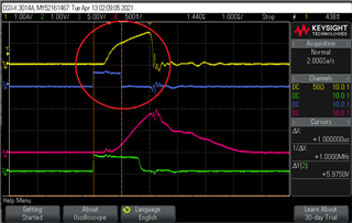

I need help to solve an issue we have here with a new design.
The schematic is above.
This is an LED driver output/protection channel.
In normal operation, the channel can hold 90W at 48V, so ~2A load.
I am using LMC6482 to monitor the output current on CH1 load.
The ST microcontroller spits out PWM duty cycle at 3KHz on DIM CH1.
We’re trying to achieve deep dimming with a 1us minimum pulse, so to achieve deep dimming at 0.05% duty cycle we reduce the frequency when Vdimmer gets below 2.5V, so at 1V dimming input we use 500Hz to achieve 1us minimum pulse.
In normal operation, we sense the current load through the 90.05Ohm resistor R35, and the signal is then amplified by U7 and feed to pin 12 into STM32G070CBT6.
The PWM on DIMCH1 is in response to 0-10V input dimming analog signal.
Also this signal is used for feeding into FW or HW protection circuit, in case of an overload or short circuit.
With values for R36, C26, C17 I get the wave forms below.
As it can be seen, the output signal I_sense_CH1 is squared and follows the input signal for duty cycles down to ~3.5%. Then the output gets distorted.
I need help to understand why this is happening, and what can we do to clean up the ripple and square up the signal.
Attached:
Scope 555- waveforms for Vdim = 6V: yellow=load; green= signal at TP50; pink= signal at pin 3; blue= signal at TP19
Scope 553- waveforms for Vdim = 4V
Scope 551- waveforms for Vdim =2V
Scope 550- waveforms for Vdim =1V
Thank you

    There are three reasons for the output signal distortion you see.
    First, the op amp response is limited by a slew rate and in the case of LMC6482 the minimum slew rate is 1V/us - see below.  Thus, for the output to move a full 1.5V would require a minimum time of 1.5us - hence, you need an op amp with much higher slew rate so the output signal may move full scale in fraction of us.
    A second problem is that in order for the CMOS op amp like LMC6482 to get into a full slew, the step input signal voltage must be a large signal: 1V or higher.  Using 100mV signal you show will not push op amp like LMC6482 into a full slew. However, using 100mV input step with bipolar input op amp like OPA2210 or OPA2206 will force it to slew.
    A third problem is that even with much higher slew rate any op amp output response in the circuit below will be limited by the 1.5us time constant of the feedback RC components you use - see below.  To correct the problem you may need to lower C17 down to 10pF.

  • Hi Marek,
    I got today the part, and made these measurements.
    My concern is at the end of this message..
    Yellow= load
    Blue=DIM_CH1
    Green= input at pin 3 op amp
    Pink= op amp out (TP19)

  • Mariana,
    You make references to C27 and TP19 but I do not see either one of them on your schematic - see below.  Do you mean C26 when you say C27?
    In order for the op amp to slew, you must apply a large step input signal at TP51 (see above).  For this reason you do NOT want to have any caps like C26 - including the cap filters out sharp edges of the input signal that are required to force op amp to slew.
    A second requirement for op amp to slew is to have a large input signal: >1V step for CMOS or >100mV for bipolar input op amp. But looking at the scope picture below I hardly see any input signal - for 2A load the iinput signal (green) should be 100mV but for 1A it would be only 50mV - that is not enough.  BTW. please use 100mV/div (instead of 500mV/div) on the scope to show your input signal.
    You need to increase the input signal to at least 100mV, which means for 1A load you need to use 100mohm R37 or change the connection as shown below.
    Thus, please remember you do NOT want C26 at all, TP51 step signal must be at least 100mV and your C17 must be 10pF or less.

  • I believe the overshoot on pin 3 must be a direct result of bouncing load current as it is being turn-on and turn-off.  But for the voltage to go 0.5V negative, the load current would have to instantaneously reverse direction – the only way I think this is even possible is due to a large switch inductance/capacitance.
    But to answer your first question, in addition to bipolar input technology and minimum slew rate requirement, the op amp linear voltage range on the input and output must include a negative rail (or within mV’s above ground).
    As far as your second question goes, bipolar, CMOS and JFET are different technologies – only bipolar input op amp will slew with 100mV step voltage input.  General purpose or precision may use bipolar, CMOS or JFET technology and distinction between the two refers to product specifications – precision op amps include op amps with the input voltage offset of 1mV or less while general purpose with offset greater than 1mV.

  • Mariana,
    The op amp amplifies the input signal and thus its output can ONLY be a gained up mirror image of the input or filtered out signal (slowed response) - the output cannot be a square pulse if the input is anything else.
    Therefore, you must clean up the load input signal to make it as close as possible to a square pulse if you need the output to be a square pulse. Using faster transistors may help but before you do anything else you need to determine where the delay occurs by probing nodes shown below.

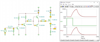

  • Hi Mariana,
    thanks for the feedback.
    Here's the result of the TINA-TI simu:
    mariana_mosfet_driver.TSC
    Looks very similar to what you measured:
    Kai

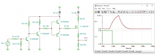

  • And here with ideal driver:
    Please note not only the different edge rates but also the different output voltage scalings...
    Kai
  • So the MOSFET isn't fully turned-on:
    See the way too low "VP_9" voltage Scream
    Kai
  • Hhm, there seems to be an issue with the model of SIR122. Trying again:
    mariana_mosfet_driver_3.TSC
    The driver can be speeded up by making the collector resistors more low ohmic, as Marek already mentioned, and by transforming the transistors into "Schottky transistors":
    mariana_mosfet_driver_2.TSC
    Kai
  • And with your 2N2484/2N3906 transistors:
    mariana_mosfet_driver_4.TSC

  • Hi Mariana,
    the Schottky diode forces the collector emitter voltage of the turned-on transistor to not fall under 0.3...0.4V and prevents the transistor from saturating. This results in much faster switching.
    Search in the www for "Schottky-TTL".
    Kai

    The scope shots are taken on the unit with Schottky diodes added (I had BAT-41 in the lab).
    I have tried also to decrease R28 from 10K to 1K, but that damaged the Q4 and R32 on this board, and loads stayed at full ON. I repaired the board. Tried another one and did the same.
    So, do you have any idea why Q4 does not switch well?
    Thank you,
    Mariana
