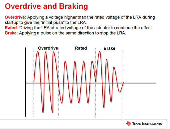

(1) setting the ODClamp register
Could you please let me know the setting method of ODClamp register ?
We use the actuator which has 2Vrms rated.
Thus, we should program the Rated Voltage below 2V.
However, I can't understood the basis of deciding ODClamp register.

  • Ryuji-san,
    The OD Clamp can be usually set around 3-3.3V for a 2V rated LRA. OD clamp register affects the startup time of the actuator.
    The attached waveform looks like rated voltage is 1.59V.

    Could you please let me know where in the waveform without LPF would change when we change the ODClamp register?
    I understood that the following.
    Change the Rated Voltage ---> Change the Duty of DRV2604 Output
    Change the ODClamp        ---> Change the Amplitude of DRV2604 Output
    Ryuji
  • Ryuji-san,
    The OD clamp is the "initial push" given to the actuator at the start of the waveform. During OD Clamp phase, the motor is driven at higher than the rated voltage for a quick startup.
    Below is a picture of what it looks like. The rated voltage is used during normal operation of the driver.
