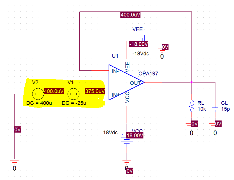

I intend to use OPA197 PSpice model to do Monte Carlo analysis in PSpice software.
1. OPA197 PSpice model showed "V_OS N035 N041 17.12e-6". Is that means the input offset keeps constant at 17.12uV?
2. If the answer of Q1 is yes, how can I simulate the changed of input offset of the OPA197 in a range from -400uV to 400uV in Monte Carlo analysis using PSpice.
