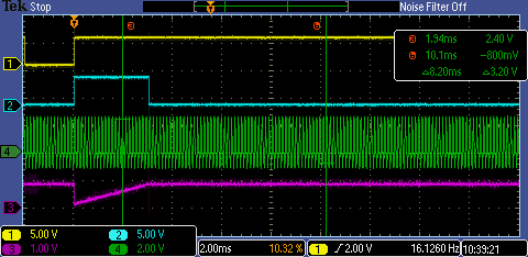

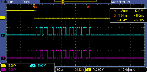

    First, the SPI. The bit sequence sent is the following:
    byte 1: 0x0046      -  01000110
    byte 2: 0x00E1     - 11100001
    byte 3: 0x002A     - 00101010
    byte 4: 0x00A2     - 10100010
    byte 5: 0x008A      - 10001010
    byte 6: 0x0071      - 01110001
    The result is in the first image. The problem may rest in the fact that we continue to see a perfect mirrorr of the sent bits, which I understand means I am not being able to get the part to enter into advanced SPI mode.
    However, the operation would appear normal, if we look at the second image. The yello trace is the CS, the cyan is the INT window, the green one is the input frequency and the purple one, the output. Here, we just have a low analog result, lower than expected, but qualitatively, everything seems to be in place.

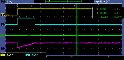

    The problem is that output remains unchanged when input signal is switched off, as can be seen in the third image.

  • Daniel,
    I tested your setup and do not get those results. It may be better to work this out over the phone.
    Please send your contact information to me at t-cosby@ti.com.
    Tom
