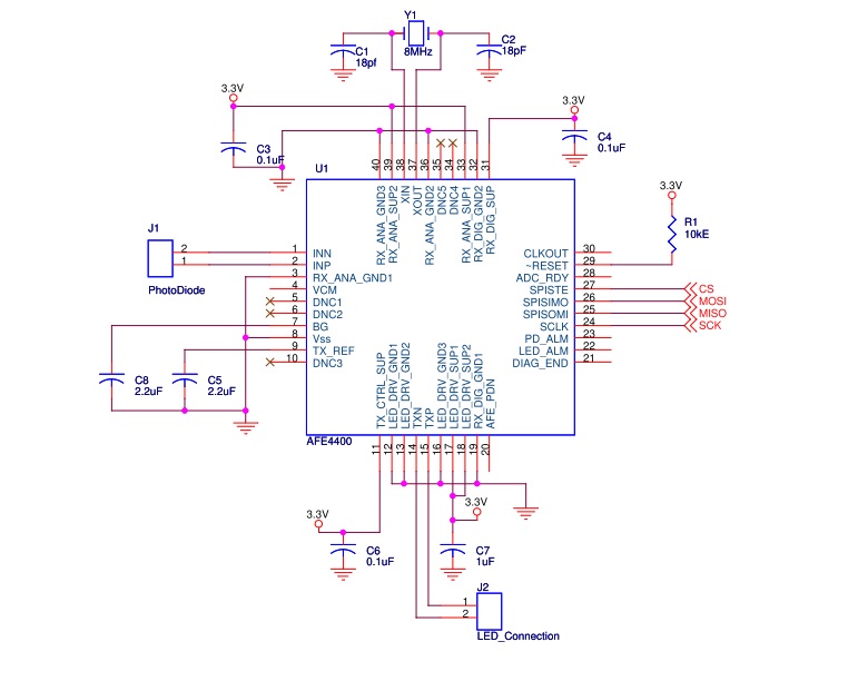

Hi ,
I brought AFE4400 for pulse oximeter testing, I read the datasheet and came up with the schematic ( almost similar to application schematic ), I need suggestion on the schematic attached in this post.
I going to use arduino to interface with AFE4400.

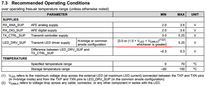

I have a doubt whether I can run the AFE4400 with 3.3V only.
I also looking for procedure for troubleshooting AFE4400 ( both hardware and software ).
Also important notes before I should keep in mind while working with AFE4400.
