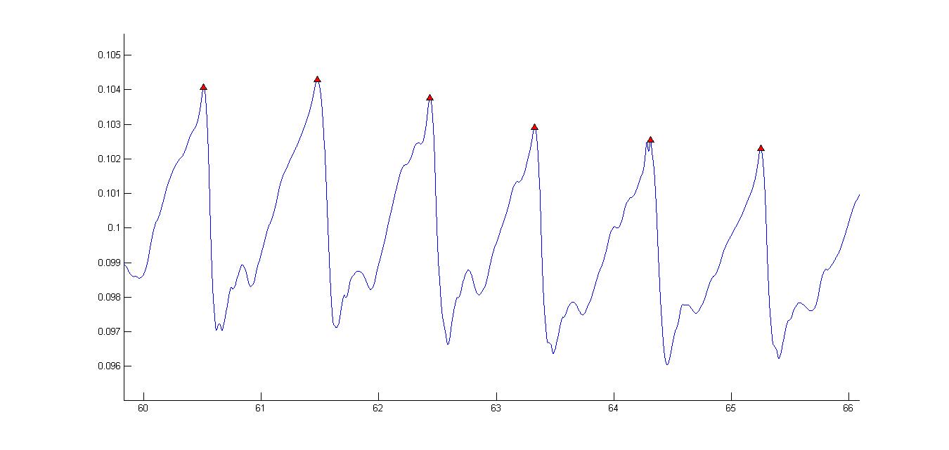

  • Hi Ming and Amy,
    I have a similar question.
    I use the AFE44x0SPO2EVM development kit together with MatLab and am getting this signal from PPG (mVolts x Seg). dicroctic notch is on the left of the peak
    According to several bibliographical references the PPG signal should read: dicroctic notch is on the right of the peak.
    Desenvolvimento de um Sensor deFotopletismografia para Monitorização Cardíaca para aplicação no Pulso (Rui Miguel Silva Martins, Coimbra, 2010);
    What should I do to extract an acquired signal? What is the reason for this "mirroring" of the PPG signal?
