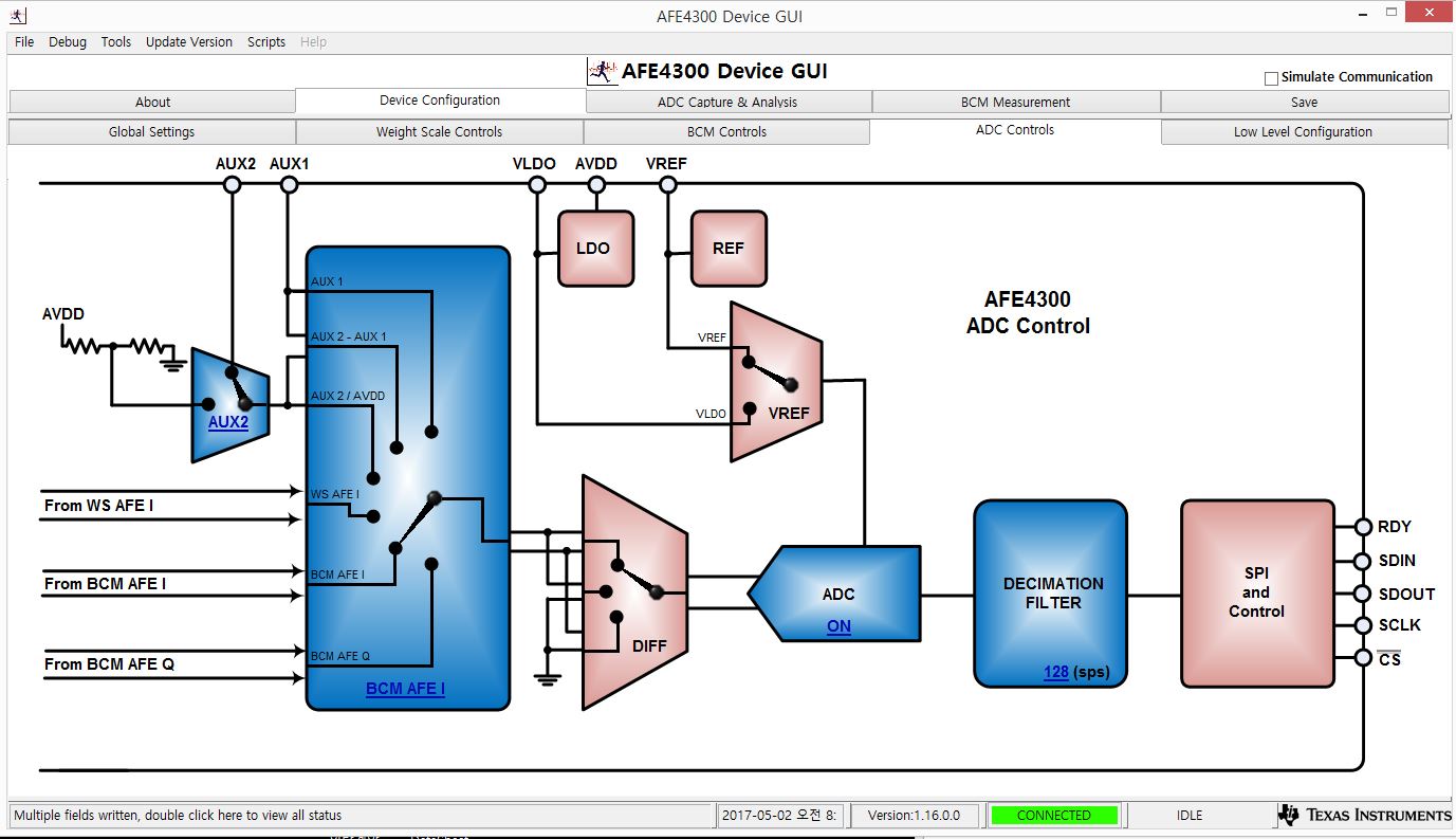

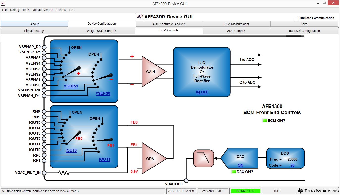

For BCM measurement, I set it as below picture(PICTURE1, PICTURE2)

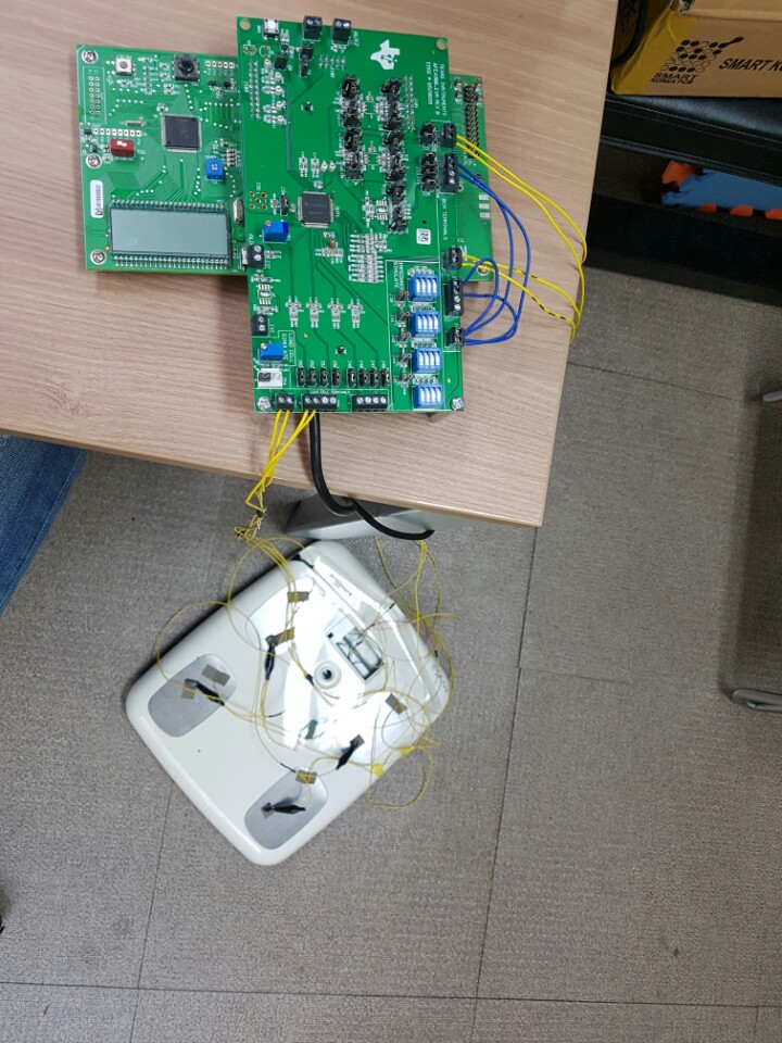

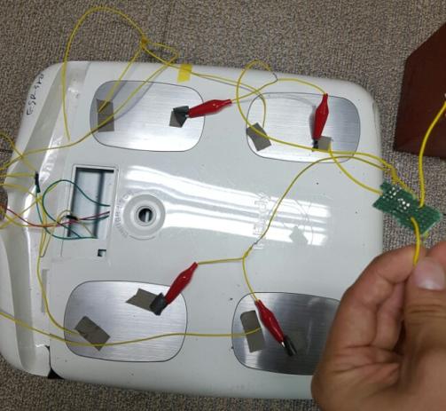

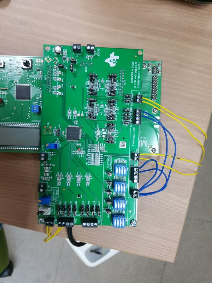

and To measure human impedance, i connected the AFE4300EVM-PDK and the electrodes as shown below(PICTURE3, PICTURE4).
you can see the yellow cable connection.

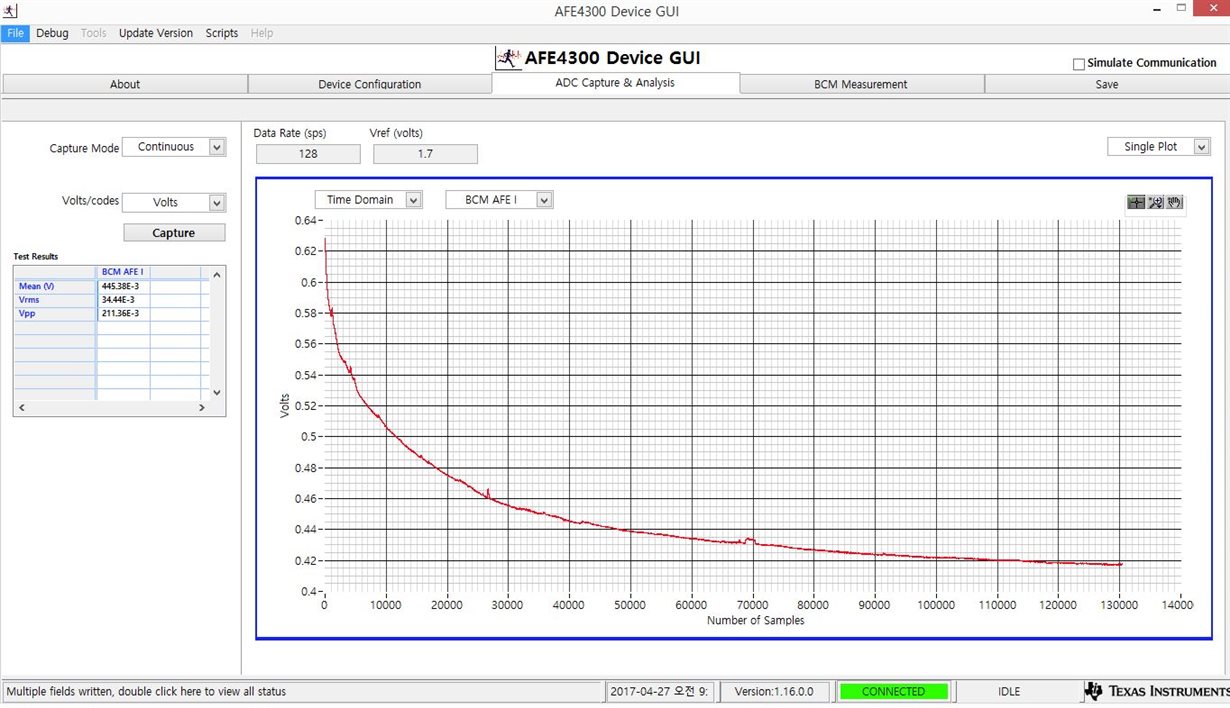

As i measure up over the electrode, the voltage value corresponding to the impedance continues to decrease with time!!!  (You can see the PICTURE5)
After calibration, the impedance difference between the initial voltage value and the last voltage value corresponds to about 50 ohms. it is impossible.
When connecting to a passive element(Resistor,Capacitor), the voltage value is constant over time.
Only when a person is up, the voltage continues to decrease with time.

    1) It might be due to variation in electrode-skin contact impedance. Is it same phenomenon across people?

  • Sorry for the late reply.
    A: Other people still have impedance decreasing over time.
    2) If you wait sufficiently long, does the value becomes stable?

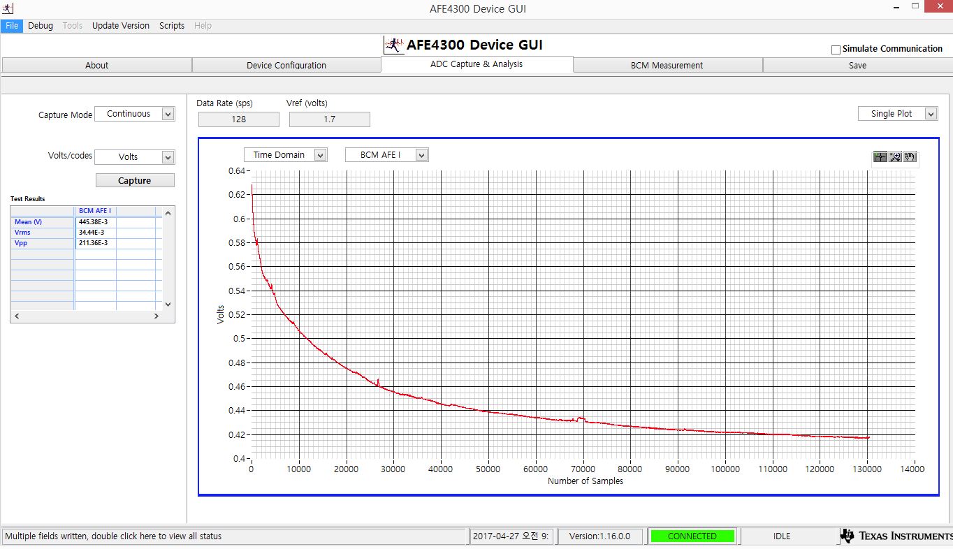

    A: I stood for 17minutes like the picture 5, but it did not converge.
    3) What is the BCM_DAC_FREQ? Is it FWR mode of IQ mode. Can you please try for different frequencies as well as different mode.
    A: As you can see in the picture.1, the frequency is 20kHz

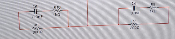

    And we made human impedance model like picture 6
    According to the formula, the impedance value at 20 kHz should be 538 ohms. Like picture7

    The same is true for 100kHz
    According to the formula, the impedance value is 472 ohms.
    the result obtained after calibrating the result obtained from 300 ohms, 500 ohms, and 700 ohms results in an impedance of 488 ohms.
    Perhaps the larger the frequency, the smaller the reactance of the capacitor, which reduces the difference between the formula value and the calibrated result, but still has a large error.

    1) Are the values of components in the human body model exactly same as mentioned? What is the tolerance level? Will you be able to measure them with external LCR meter.
    2) Just to remove any mismatch ( due to parasitic caps because of wires) between the calibration path and body impedance path, can you put the human body model on the EVM and try.
