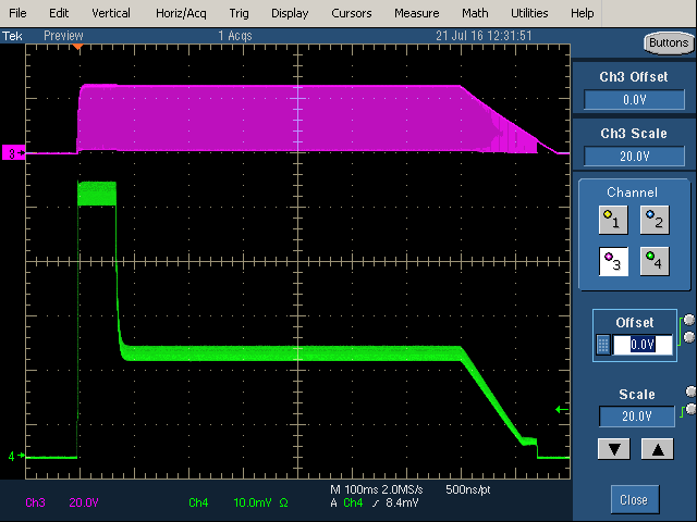

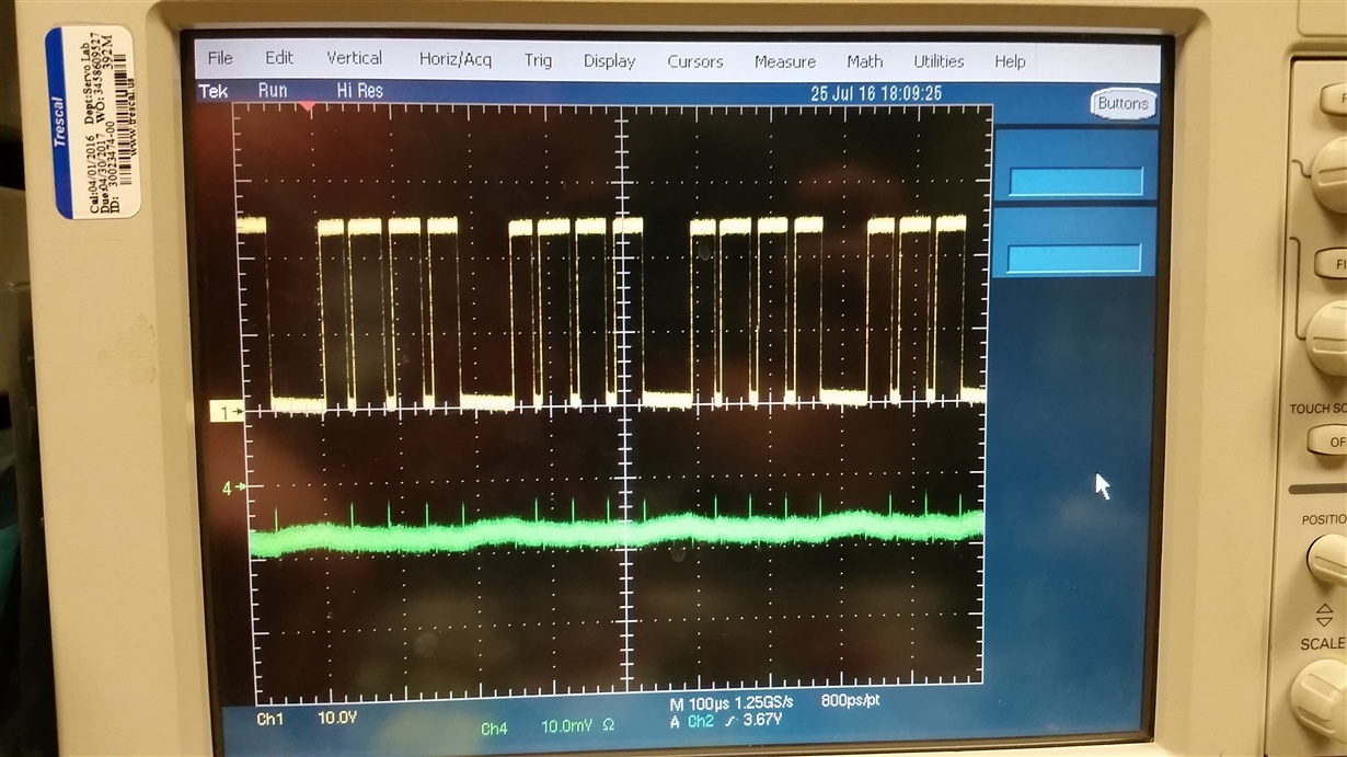

    The functionality of the DRV120 should not be affected by the inductance of the coil. I did some tests in the lab today, and did not see any issues with the output waveform. I used the DRV120EVM for testing and supplied it with 24 V from a bench power supply. For these tests, I used ~200 Ohms for the OSC resistor (adjusted with potentiometer). The device on the EVM board is the DRV120A (14-pin version), so I was able to adjust the peak and hold values. I found that if I increased the HOLD current, that the audible ringing of my relay would get quieter, so that is one thing you can try to reduce the ringing, but it will mean you need to use the 14-pin version instead of the 8-pin.
    This scope shot is from a relay w/ a coil measured at 600mH and 660 Ohms. The current profile is in green (20 mA/div), and the OUT pin voltage is purple.
    This scope shot is from a solenoid measured at 20 mH and 11 Ohms. The current profile is in green (50 mA/div), and the OUT pin voltage is purple.

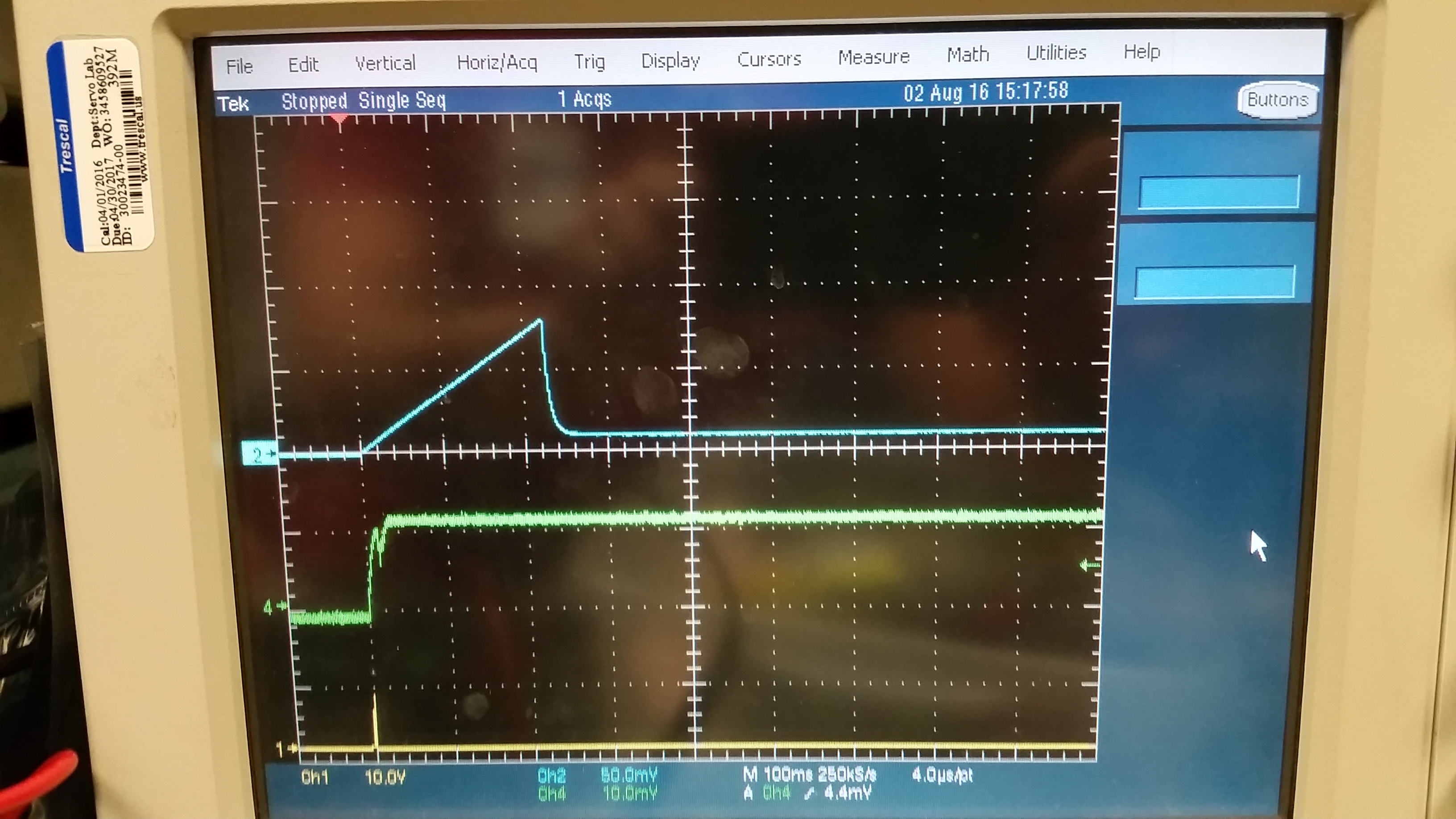

  • Marcel,
    Can you please take another scope shot for me?
    - Use a resistor greater than 160 kOhm for ROSC
    - Supply your board with some voltage between 12-24 V
    - Take the scope-shot with a time scale of 100-200 ms/div - I want to see the full current profile going from peak to hold
    - Show traces for the current through the solenoid and the voltage at the out pin

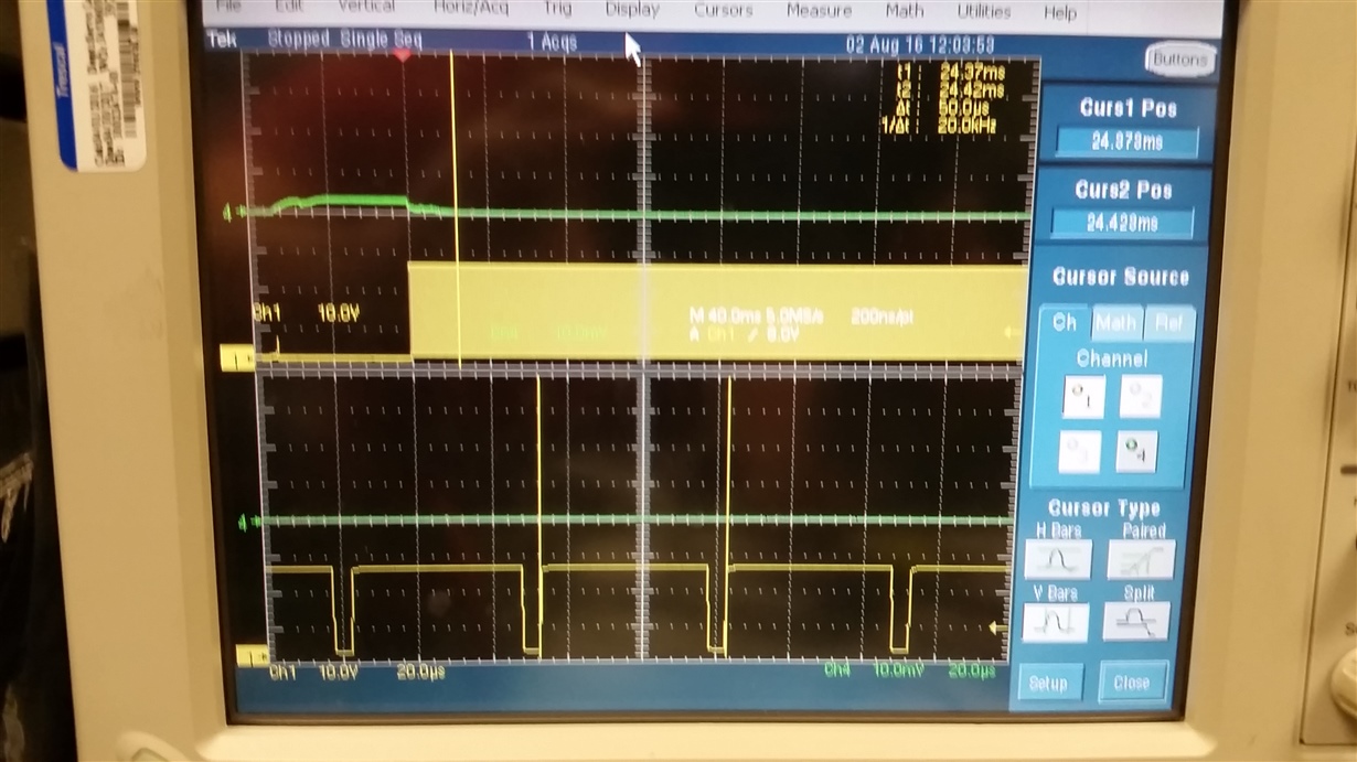

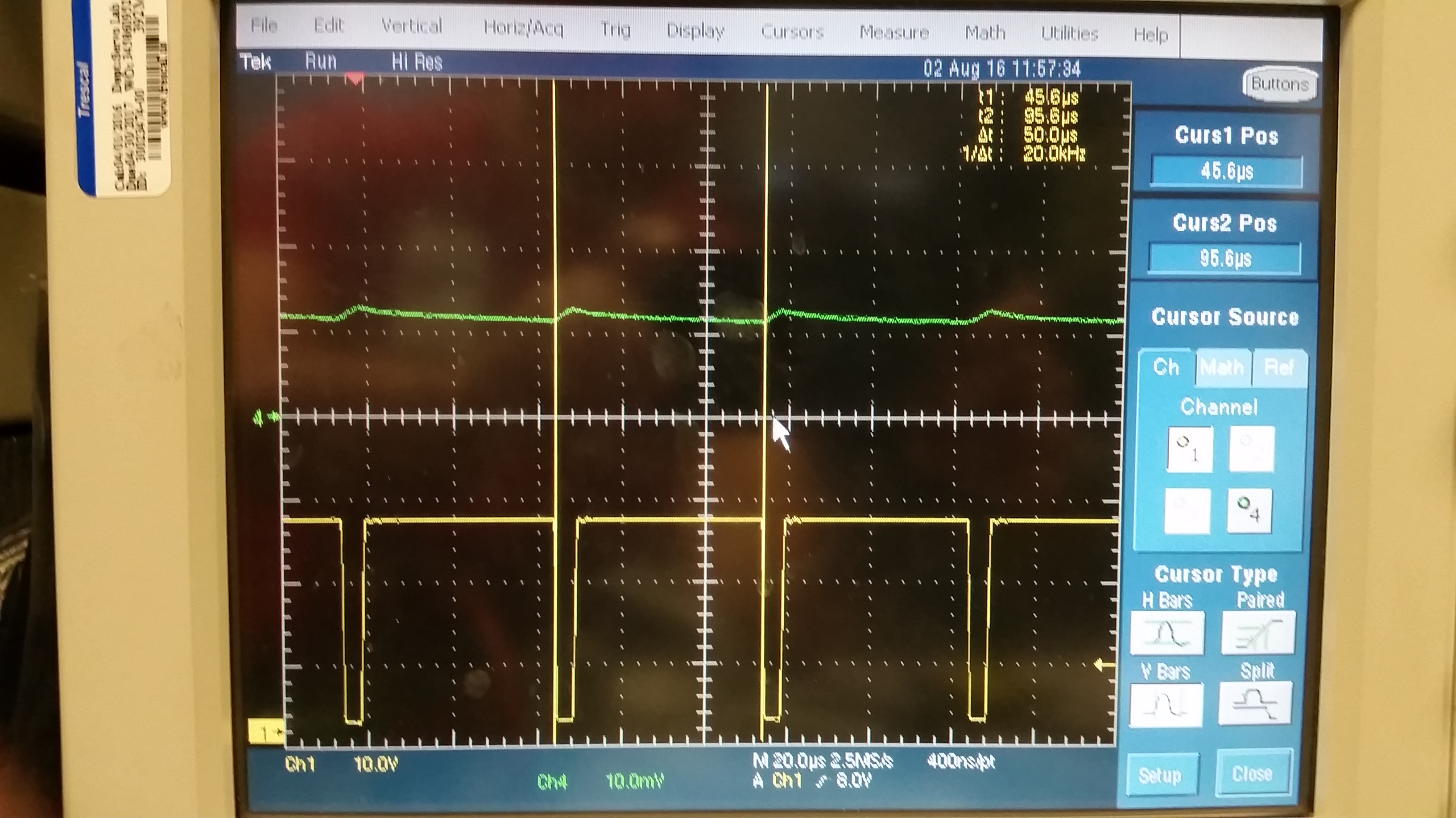

  • Can you tell me what is the frequency is on the output when in hold  current.
  • Marcel,
    I took a couple more scope shots, zooming into the hold section. The frequency looks like its ~21-25 kHz.
    20 mH
    600 mH

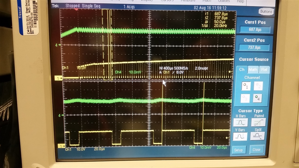

    I've done some further investigation on this issue. Inside the 8-pin device, HOLD is left floating. I took the potentiometers off of the DRV120EVM and used the 14-pin device like the 8-pin device by floating the HOLD pin. I then grounded the OSC and PEAK pins, so they were set to default settings. The interesting thing I found was that a low-resistance, low-inductance coil performed as expected, but the high-resistance, high-inductance coil (one that is similar to yours) had issues. My scope shots are below.
    From what I observed on the bench, I believe that if you use the 14-pin device and do NOT float the hold pin, you should get reliable performance.
    Thank you for bringing this issue to our attention. We will need time to do further investigation here and improve our products and documentation.
    Let me know if you have any other questions.
    20-mH, 11-Ohm coil
    600-mH, 660-Ohm coil
  • Hello James,
    Can you tell me what the switching frequency is during the peak current and during the hold current at the 20mH 11 Ohm coil?
    Can you tell me what the switching frequency is  during the hold current at the 600mH 660 Ohm coil?

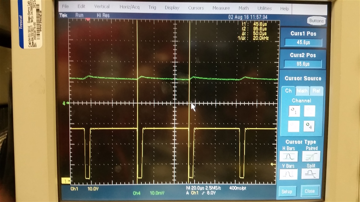

  • Marcel,
    Let me answer your first two questions in this post, then I will respond to the others.
    With the OSC pin to ground, the frequency is 20 kHz. I measure that for both coils.
    20 mH
    PEAK
    HOLD
    600 mH
    HOLD (Ipeak is V/R because resistance is large and regulation is not needed)

  • Marcel,

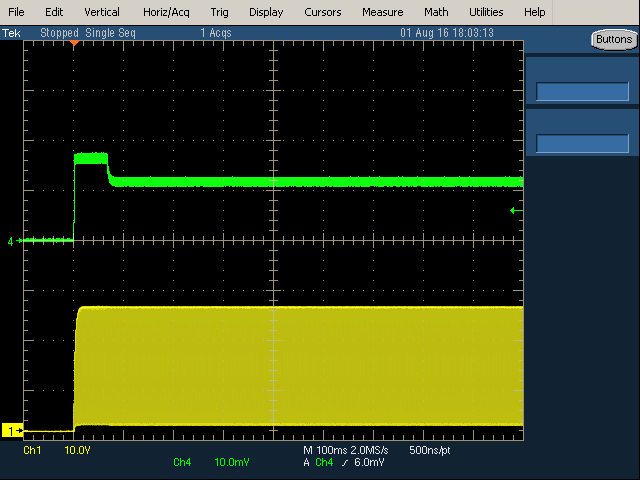

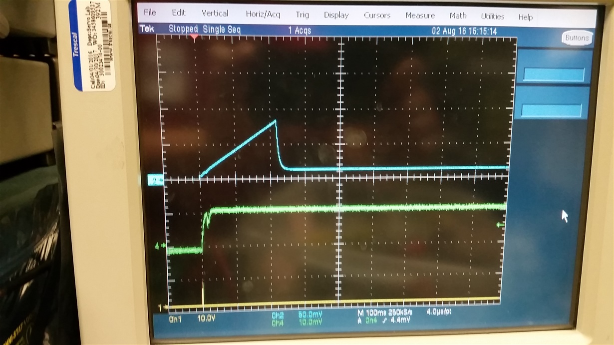

    This afternoon I was able to do some bench testing with the 8-pin device. For me it  worked properly with the 600mH coil. This result was unexpected compared with my results from the 14-pin device where I floated the HOLD pin. However, it is good to know that at least for this test, the 8-pin version is working correctly.
    The scope shots below have the following setup: blue = Vkeep, green = Isolenoid (50mA/10mV), yellow = OUT. I replicated your schematic on a breadboard for these tests.
    Rosc = 68k - here the device is not in the operating region because the Rosc is too low. We can tell that the device does not go into the PEAK state because Vkeep isn't increasing. We can't see the PEAK state in this waveform because V/R is lower than the threshold for the sense current.
    OSC pin connected directly to ground - In our testing we found that this is a stable operating state. Here Ckeep is charging correctly.
    Rosc = 160k - This is also a stable setting
