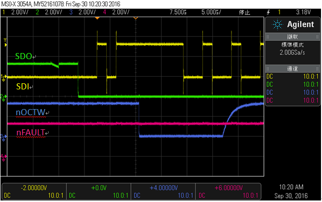

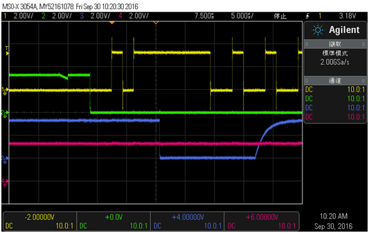

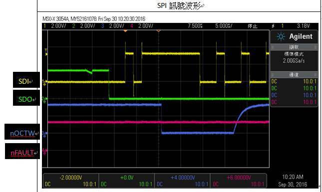

I have project need to work on 85degC. I have some question.

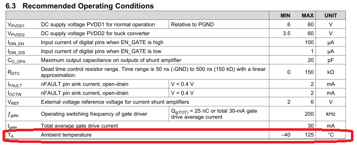

Recommended operating temp = -40~+125. But...

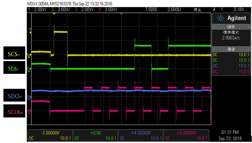

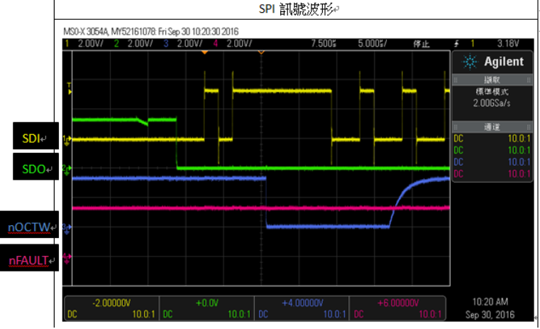

When Ambient temperature = 25degC : The waveform is good.

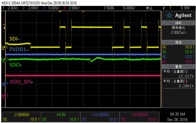

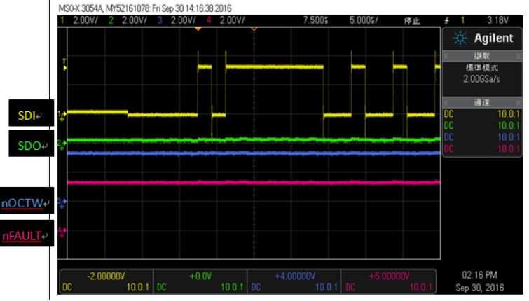

When Ambient temperature = 85degC : The SDI(IC SDO) is bad. It can't feedback any signal and can't start up.
If we are change chamber temperature =79 degC. It will restore.

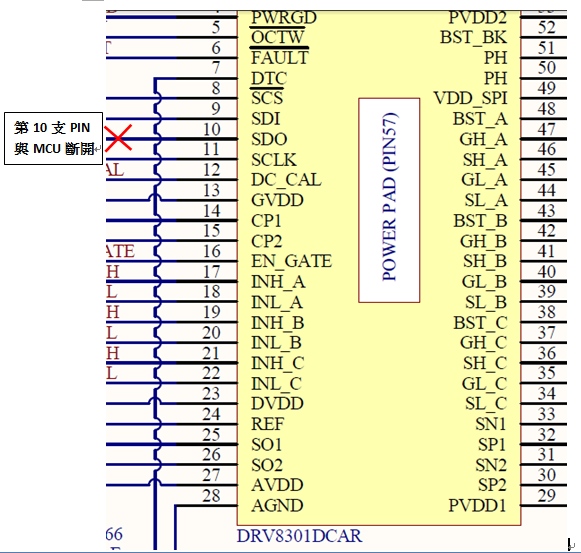

If we are cut pin10(DRV8301). When 85degC. same result.
