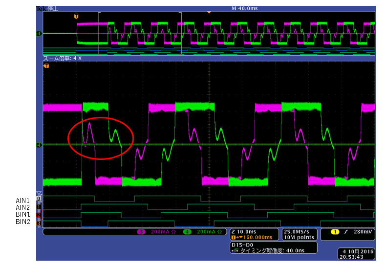

My customer is using DRV8881PEVM and customer motor.
Then, he has a issue.
Please see the below picture.
This is current waveform.
Motor operates at 1-2 phase.
Do you know the reason of red circle of this picture?
Shimizu
  • Hi Shimizu-san,
    It appears the stepper code uses brake mode instead of coast mode in the areas highlighted.
    We will confirm this and reply soon.
  • Hi Shimizu-san,
    Can you confirm the 4 digital channels on the scope capture? What signals are they from top to bottom?
    Also, please provide the firmware version of the EVM (listed on the GUI).

  • Hi Shimizu-san,
    Thank you for the information. Using brake instead of coast may be the cause of this current.
    The MSP430 firmware for the EVM uses coast mode, and allows the current to decay to zero through the body diodes.

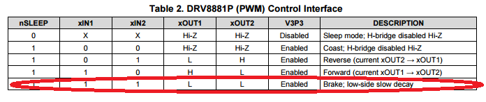

  • Hi Rick,
    Thank you for your reply.
    Please see the previous post waveform of lower left.
    Customer operated IN1/IN2 of DRV8881P to High/High for decay(slow decay).
    There is following table in datasheet.
    Is this correct?
    Shimizu
  • Hi Shimizu-san,
    Yes, the table is correct. xIN1=xIN2=1 is Brake; slow decay
  • Hi Rick,
     Today, I took about this issue with my customer.
     This issue occurs only at low speed. For example 250 pps.
     When motor speed is 2000 pps, This issue does not see.
     (VM=24V, Itrip=500mA, default EVM setting, )
     At previous post, I confirmed that Input signal of customer is correct.
     I think this issue is related to speed.
     Could you give me comment about this, please?
    Shimizu
  • Hi Shimizu-san,
    Sorry for the delay. I also think this could be related to speed. At higher speeds, the next step appears before the current has a chance to increase.
    In the DRV8881PEVM, coast mode is used for the zero current step.

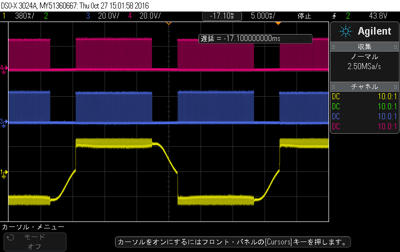

  • Hi Rick,
    I confirmed customer motor and DRV8881P with external MCU at 1-2 phase operation.
    I could occur this issue.
    And also, I could other stteper motor, too.
    This is A phase output voltage of DRV8881P and motor current at customer motor.
    At 0A current operation, DRV881P output(AOUT1/2) is Low.
    In the other word, Brake(Slow decay).
    But current is not operated to 0A.
    I guess that the cause of this issue is that decay is not enough.
    Q1 : Is this guess correct? Do you think about this guess?
          -> I need to explain this issue mechanism to customer.
    Q2: If this guess is correct, is there countermeasure against this issue at DRV8881P?
          -> Coast step? this is your opinion at privious your post.
    Q3: If we use DRV8881E with AutoTune, Is this issue solved?
    Shimizu
  • Hi Shimizu-san,
    Yes, brake mode (slow decay) causes the current to decay slowly. As the motor speed increases, there is less time for the current to decay to zero.
    Yes, the countermeasure is coast step (asynchronous fast decay). This will remove the current quickly.
    AutoTune will have no effect.
