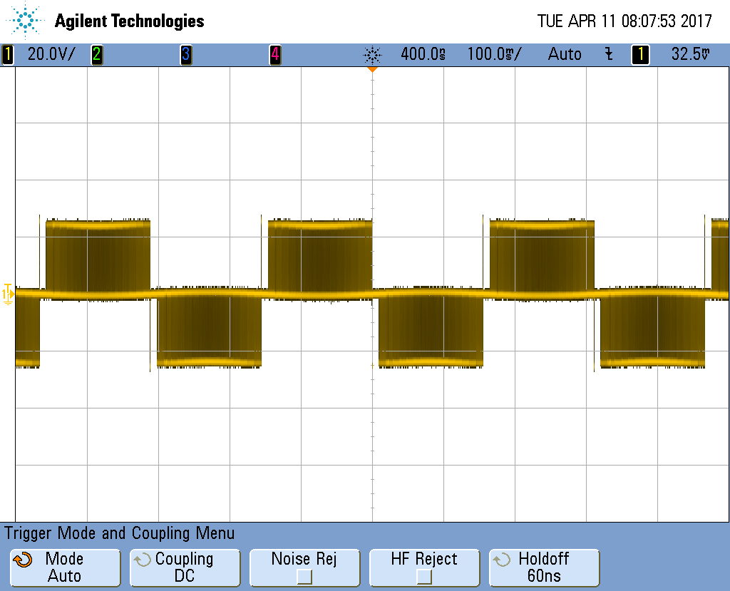

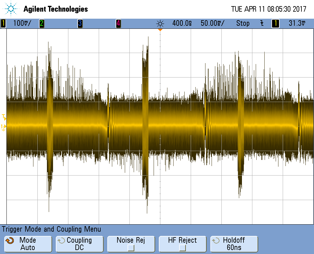

    It looks like one phase is completely lost in the erroneous case, while the other one is still working (e.g. no current drive through the winding A while winding B looks normal). We observe holding torque, but the motor only moves into one direction (predominant direction, caused by gravity) when the driver receives a step signal. The movement occurs with larger step size than usual.
    A power reset helps to recover, but is not a solution for us. Our devices have to run continously in industrial environment. Resetting the chip by pulling the RES line low does not help in most of the cases. So far, we only experienced one case where the chip recovered after 20 resets.
    Below are two measurements, both measured between OUT1/2 of the two phases. The first measurement shows the lost phase, the second the working phase.

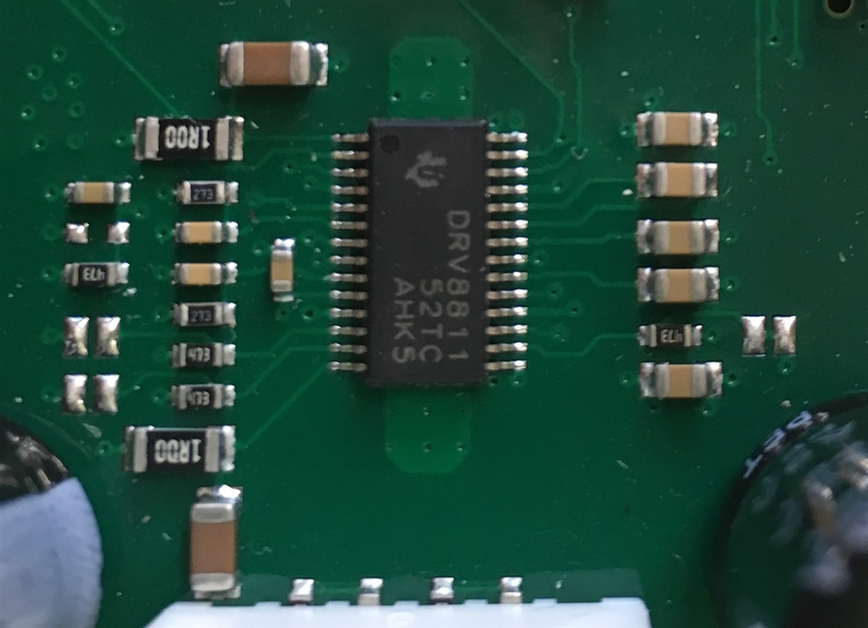

    Thank you very much for the information provided. We are in the process of identifying if the devices are from an old silicon revision but we are unable to trace the 54TC marking. Could you please kindly send a picture of this device? If you prefer you can send it through a private message.
    Thanks again.
  • Could you please answer my questions regarding the 8818 ? If it is compatible and not affected by the silicon bug, we will replace the 8811 with this part. At least for the current PCB batch.
    Below are the pictures you requested.
    Thank you for the pictures. We have not been able to track the 54TC marking. The 52TC is not from 2005 since this part was released in 2008. We would like to have these parts back to do a test analysis. Please work with your distributor to start the return process. I sent you a message with my information.
    As far as your question, the DRV8818 devices are not affected by the bug of the DRV8811 old silicon. Thank you very much.

    The 52TC marking has the latest silicon revision and should not have the old bug.
    We could not track devices with 54TC marking. Counterfeit of part is very unlikely but a possibility since no records are shown. We will be able to determine this if we get parts back for testing. Thank you very much.
