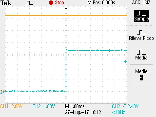

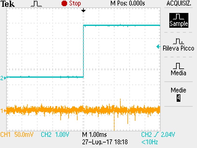

    Can you capture the AVDD, DVDD, GVDD signals to ensure all regulator voltages are within tolerance?
  • Hello, that's me. Not a professor btw, just a PhD student.

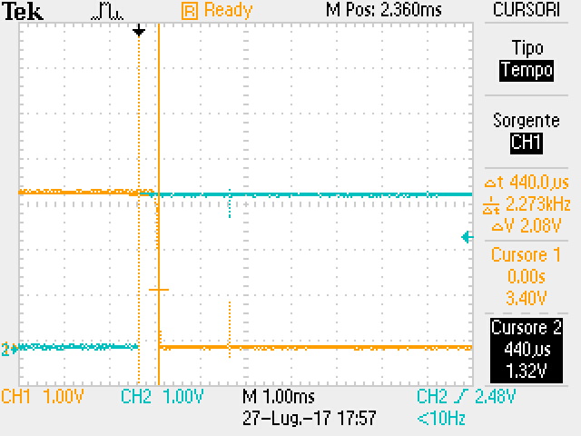

    Concening to your first question the nFAULT pin goes low al long as the EN_GATE stays high. If EN_GATE is set low nFAULT generally goes high again (not always though).
    here are the screenshot u requested they look quite understandable although in italian. Let me know is something is not clear the EN_GATE signal is the green/grey one:

    EN_GATE vs nFAULT

    As said they are in their tolerance. and there is no shorts around. Also the Buck reg works fine.
