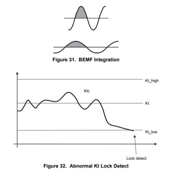

    Let me explain how Abnormal Kt Lock works: Our device takes the programmed Kt in the GUI and compares it to the estimated Kt (because measured Kt is not completely accurate) by our device. The estimated Kt will vary during operation some amount but our device determines it should stay within some threshold of the programmed Kt. This is shown by the picture below (imagine the estimated Kt is the line). If the variance is outside the threshold for too long, it triggers the lock. In summary, your "manually set Kt" actually determines where the threshold is. You can check out the Lock2: Abnormal Kt section of the datasheet for more information.
    The "reported BEMF" (I called it estimated Kt) deviates because it depends on current throught the phase, voltage applied to the phase, Tadv, programmed motor resistance, and motor speed. It can calculate Kt different based on these factors and compare it against the programmed Kt (we actually do this for the speed abnormal lock1. feel free to check out the datasheet for more information).
