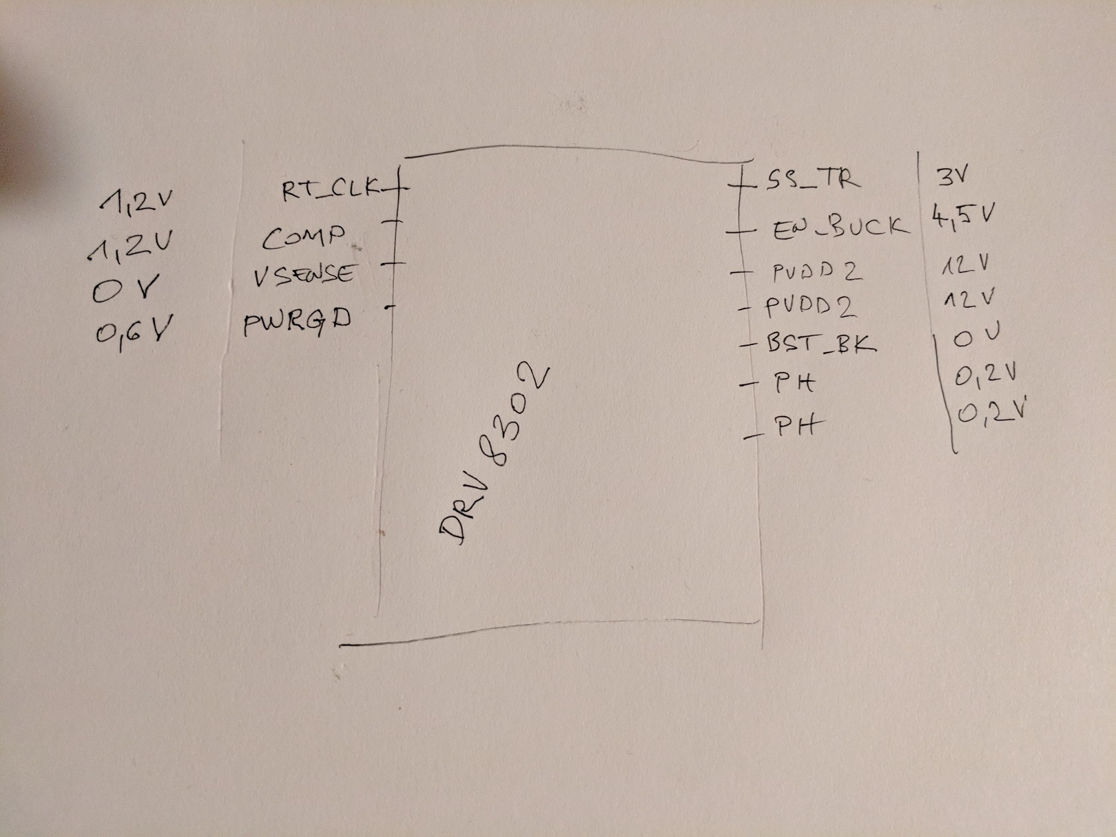

it seems I have problem with buck converter of DRV8302. I soldered it acording to this schematics:
The voltage levels I get on relevant pins are as follows:
I am powering chip with 12V VDD.
(not)FAULT is pulled low - can you maybe suggest what else could I check to find what is causing this non desired operation.

  • When I turn on 12V power supply BST_BK goes slowly (in 5second timeframe) to 5V, but PH stays all time at 0V.
    Also Vsense stays 0V all the time, but I see corect ss_tr and en lines as per TPS54160 datasheet:

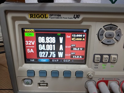

    I made motors turn on 12V power supply, than I tried on 24V, and driver became hotter - and went into FAULT state. the current consumption (shown on power supply) got to 187mA.
    Now it reports FAULT also on 12V and I couldn't make motors turn anymore - what could be wrong ?
    When I turn on power supply current consumption is 14mA, after I change PWM on INH_A and INH_B, it starts consuming 193mA and gets into fault state and stays there (could not be resetted with togling EN_GATE)... I believe 24V is well bellow operating range of this driver chip.
    Drivers becomes hot so I could not touch it for more than 3sec only.

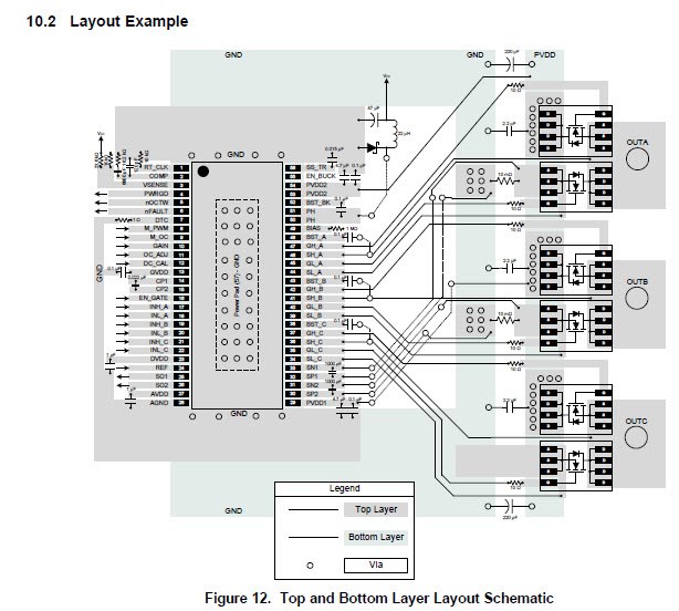

    Can you check my pcb layout (pdfs I attached) to see if GNDs - PGND, AGND and GND are connected corectly? I see in datasheet that it mentions AGND, PGND and GND, but this 3 grounds are not clearly visible on layout picture in datasheet - can you clearify or anotate that picture to make that clear?

    Regarding grounding and PCB layout, you want to make traces which carry large currents as wide as possible. This includes VM, GND, and motor phase traces. If you download the hardware design files from the following links, they provide good layout examples.

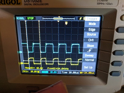

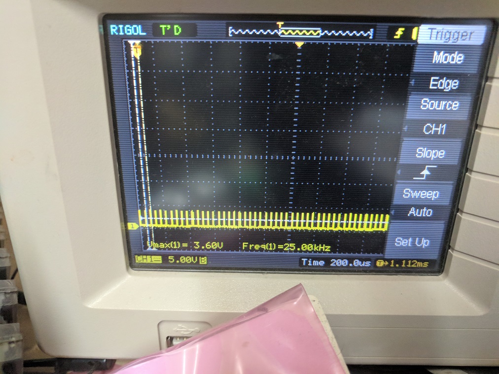

  • I was able to move motor, but mosfet are getting really hot. I can see this scope pictures:
    on PWM2 (PWM1 is 0V):
    on GL_B:
    Trying to get to the source of problem I see INH_B set to PWM freq of 24 kHz, and INH_A set to 0kHz, I get GL_B and GH_B turning on simultaneously - how is that possible?
    The only thing that gets on my mind is current limiting mode - is this current limiting I am seeing? From datasheet I read "If M_OC = LOW, the gate driver will operate in a cycle-by-cycle current limiting mode". In my case I have M_OC set to LOW.
    What is purpose of BIAS pin? For upper scope traces - I have left it floating - but will connect it to 1MOHM today to see if it makes any difference. Also on some schematics in datasheet it is capacitor connected on other schematics it is resistor connected to GND - what is the reason? What is correct way to connect BIAS?
    Is it possible that BIAS influences or is anyhow connected to current limiting?

    This are pictures taken after I soldered BIAS pin to 1MOhm resistor - however I cannot explain that whole thing is eating 4A - I have set 4A current limit and it is taking it all just for switching mosfets with no motor connected... I need to check this more in depth - to answer where is all that energy dissipating...
    I think this undervoltage events are happening for some yet unknown reason for my pcb.
    Regarding OC_ADJ - I have DAC connected to DAC from my uC and disabled overcurrent limiting with DAC outputing 3.3V to OC_ADJ (just for now when I am still struggling with proper motor operations using DRV8302).

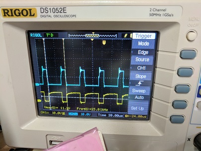

    HEreare pictures of motor phase1 (blue is GHA yellow GLA)
    motor phase2 (blue is GHB yellow GLB)
    Now this is unexplainable - why it is eating 4A on 12V - see below picture
  • Zhivko,
    If you still have undervoltage events, there may still be some trace impedance between the power-entry point to the board and the PVDD pin/FETs that causes power supply collapse. Probing the PVDD pin and the power-entry point to the board should confirm this. If the voltages are the same, the trace impedance is probably small. If they are different, the the trace impedance is an issue.
    If FET shoot through during switching is an issue, you need to zoom into the edges of the gate drive signals. If during the transitions, both of the signals are not 0 V, then shoot through may occur. However, the device protections should be taking care of this.
    Also, when you zoom into the gate drive signals, check to make sure there are is not voltage overshoot or undershoot happening on the gate or gate drive pins. Parasitic LC components in the gate drive path can cause ringing/overshoot/undershoot if the layout is bad. This can damage FETs.
    Sometimes FETs fail as a short. Check your FETs to ensure they are all operating correctly.

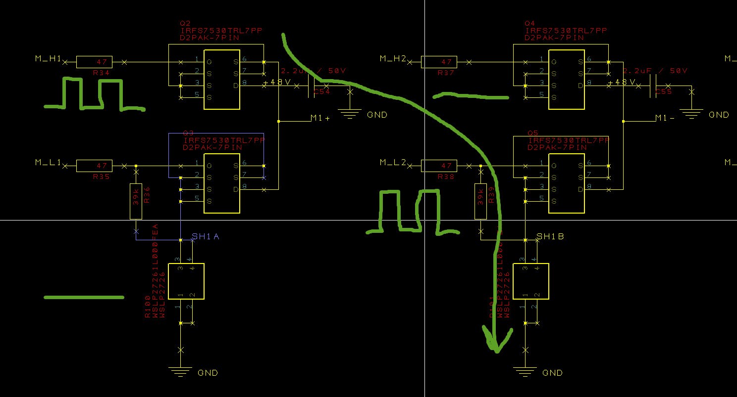

  • Ok I think there is some flaw in my thinking - I am not sure why GL_A and GH_A are inverted while PWM1 is present and PWM2 is 0V.
    I think that correct situation should be like (one of gate signal either GL_A or GL_B should be 0V) like this (0V denoted with horizontal green line):
    But actually the situation is like this:
    So as this last situation is happening - i have both mosfets short circuited - I am sure I am missing something... Why one of either gates of GH_A or GL_A is not 0 V but GH_A is inverted GL_A ?
    Here are traces:
    PWM1
    PWM2
    Gate signals - blue GH_A, yellow GL_A:
  • I wanted to try operating DRV8302 without MOSFETs beeing connected - right now I see if I remove gate resistors - chip stops outputing GL_A and GL_B - so is it possible to have GL_A and GL_B operating without mosfets beeing connected?
    Another thing - is it possible that dead time between GH_A and GH_B is so small that it happens that ground mosfet is on phase A is turned on and 12V mosfet on phase A is turned on? That is the only explanation of short circuit situation that I am seeing now - would increasing DTC help (increasing dead time)?
  • Just soldered new mosfets and problem with shorted mosfet on phase went away. :) Examining each of them tbetween drain and source there was no short - so how could I tell what was wrong with them... :)
    It kind of works now.
