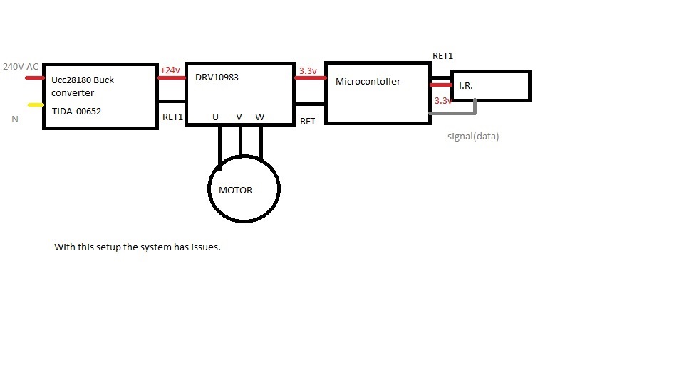

  • Hi Cole

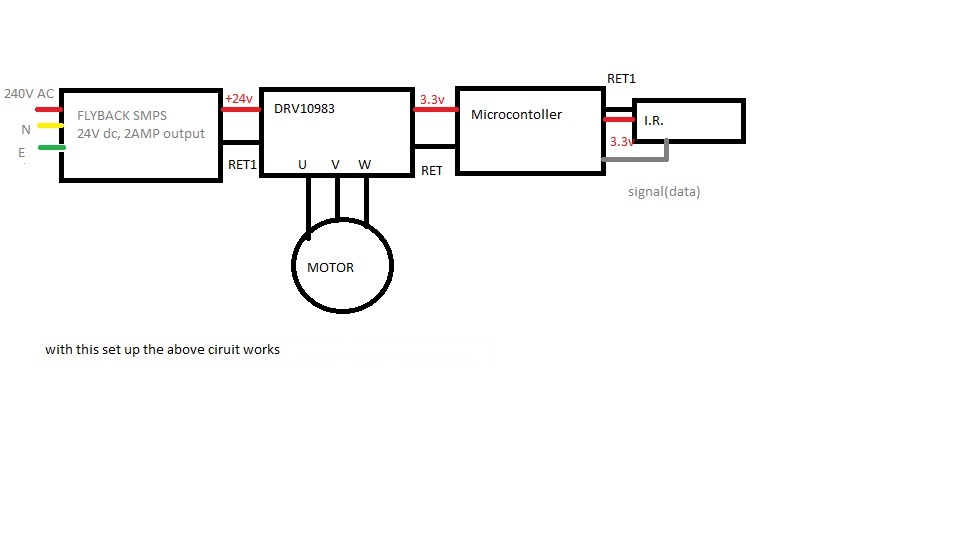

    I am attaching block diagram of the set up.
    The 3.3V is from VREG of the DRV10983, the attached controller , LED and I.R sensor in total consume 60 mA, which is below the 100mA the VREG can provide.
    I have MSP4302274 dev boards as well, I replaced the stm8s with MSP430 and get similar results.
    When the Earth of the fly-back smps is disconnected , the circuit behaves like sames as on buck converter (losses data from I.R.).
    Both the micro-controllers are programmed with similar code, continues blinking LED to show that the it is not crashing or resetting, when I.R. data received to acknowledge the interrupt the led switching Off for 1 sec , when ever  the micro-controller acknowledges the I.R., there is communication with the DRV10983.
    I will try to run the controller and I.R. of battery pack and combine the GND to RET of DRV board and check if that works  for I.R.
    Thanks and Regards
    Dinar
  • Hi Dinar,
    I suggest testing the TIDA-00652 as a stand alone power supply first to ensure there are no issues with its output voltage. It would also help if you could post waveforms of the 24V output from the TIDA-00652 when the system is not working correctly.
