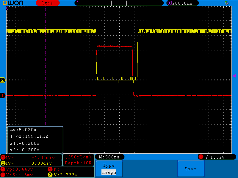

Another problem is PMP7605 reference S/W do not make proper dead time for high / low side driving transition time.
 Low to high dead time looks too enough but High to Low don't have dead time.   according to PMP7605 user's guide,
the ref S/W is making proper daed time if I see the attached pictures.
The timing confliction is related with high resolution Timer D setting,  it's just up mode, not up&down mode.
When TDR reached to TDCCR0, CCR1& CCR2 out signal looks to be toggled.     But TDCCR1  & TDCCR2 have timing
difference 20,  it can make dead time.     It's just my understanding.   Anything I misunderstood  ?
I attached the picture captured by osilloscope.

    In case of F5529 Launchpads,   As you guided, I removed the  debug com port driver in PC device manager.    But the GUI S/W  was not connected F5529 launchpad serial port.    But when I tried to start the PC GUI SW more than 10 times,   it was connected with target board suddenly.  (It's the case when I didn't  remove the debug com port driver in PC device manager).
    For overall,  GUI S/W can be connected with 5529 Lauchpad.   But connection can be done  once per 10-20 times of  GUI S/W restart trial.     If possible,   need to make some modification of GUI S/W to set com port to be connected ratehr than USB VID/PID.
    Like any other Hyper terminal S/W (Coolterm & etc).     I attached the UART waveform picture when it wsa connected.
    yellow= EVM RX,  red= EVM TX pin.     Every 1sec,  PC GUI S/W send UART link stay & update  signal.
    In my thinking ,   adding new menu to set com port will be difficulut.   How about the GUI S/W to be linked with  external
    com??.ini file to set the com port among  the com port that PC  dvice manager assigned for the dedicated H/W ?
