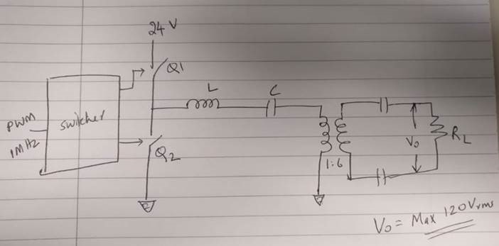

PMP10949: Looking for a isolated series resonant converter design for 24VDC to 125AC/1MHz
Part Number: PMP10949
Guys,
Is there any single chip solution to develop 120VAC (1MHz) from 24VDC?
I am looking to develop an isolated series converter design with MIC2168
I am looking to develop the below circuit
• Vin=24VDC
• Vout=120VAC, 1MHz
• Max power out at 100% duty = 7.5W (load resistance 100 ohm)
Min power out at 1% - 0.3W
Sample schematic is below.
