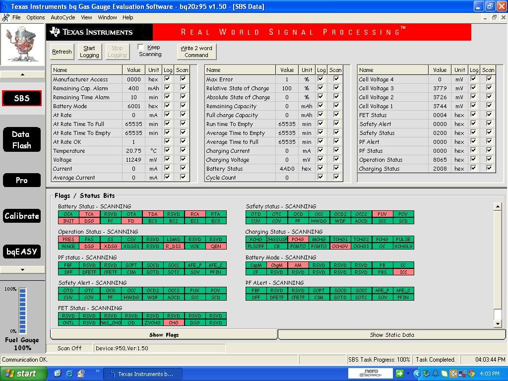

cell voltage 4 is not detected in bq20z95 gui.
Other Parts Discussed in Thread: BQEVSW
 Cell voltage 4 is showing 0 but at the pcm pad, voltage is available.
 am trying to make a pack of 4 cells in series(LFP 50ah each).I have assured it that i have connected each cells firmly. i have tried to calibrate voltage from calibration screen, but it keeps on showing 10.1V instead of pack voltage which shoyld be idelly 3.7*4= 14.8. i have tried Sbs command 004 also,but after that i am not able to connect the device with bqevsw.
i have come up with another issue immeditely before this,when GUI was recognising only 3cells.
Please look over the issue.thanks

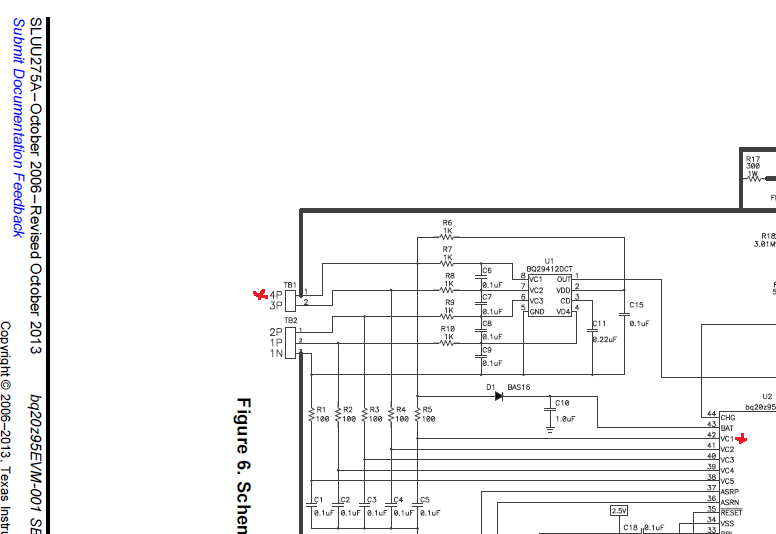

  • did you program the operation cfg A register CC0 and CC1 bits correctly for 4 cells. Can you carefully measure and check the voltages on the VC1 input pins of the gauge to make sure it sees the voltage at top of highest cell and there is not a broken connection somewhere.
    If you have intermittent bad connection on top cell that would explain your earlier problem with charging or discharging.
    Did you already do a learning cycle and manually edit cycle count to 0 as i still want to understand how it seemed you sudenly  got MAX error =1% while cycle count is 0. Is this an old gauge IC  previously used on a different pack?  As I asked in other post please give me more back ground info.
