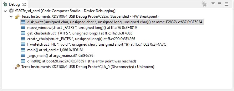

  • When does this sd_error() function get called? If you look at the call stack in the CCS Debug window, can you see what function called sd_error()?

    I have attached the image of debug window. I have commented the "sd_card_insertion();            //Check for card insertion" function. This error comes at least once in two attempts of debugging the code. I'm reading the data in "read_buffer". I want to know I'm I reading the data correctly? and which sectors of SD card can be used to write? as the write has been started from 0x0000 sector location.
    Please help.
  • Are you saying you removed the call to sd_card_insertion()? Why? Isn't that needed to provide the 74 cycle power up initialization?
    As you can see from the call stack, the error you're getting is coming from sd_command_response() which is waiting for the card to respond, saying its in the idle state. Can you put a break point in that function and see what the response value is that's making it jump to sd_error()?

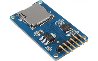

    I'm having 6 pins on my SD card adapter (clock, MISO, MOSI, Data, VCC and Ground), I'm not having the 7th pin for detection (as I'm having a micro SD card). That's why I commented the SD card detection pin at GPIO 34 in the function "sd_card_insertion".

    Is the detection of SD card required. As I'm not having the 7th pin in the SD card adapter. Is it resulting in error.
    I'm using 8 GB micro SD card. I have read in the SD card interfacing document that parallel protocol is used for SD card > 2 GB capacity (I'm using SPI now). Here I have seen the "sd_version2_initialization" is been called as I'm using SDHC card.  I'm using low speed clock (LOSPCP) of 20 MHz and the value of register "SPIBRR =0x0063".
    Okay, I understand the change you made to sd_card_insertion(). You're right--you don't need the detection pin. I was able to comment it out in the code and it still works fine for me. I am also using a microSD card with a capacity >2GB. I have not been able to reproduce the issue you're having though.

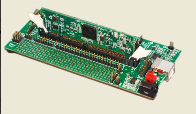

    I'm having a custom board made from TMS320F28063 IC, for debugging we are using JTAG (I have attached the image of JTAG). When I'm giving the 3.3 (V) required for the micro SDHC card from the JTAG, then I'm able read and write from SD card (with errors in response at times).
    When I use a power supply to generate 3.3 (V), then I'm unable to read and write from SD card. The response remains "0xFF00" and doesn't change to "0x0000" and "0xFE00". I have made the ground common.
    I'm also seeing now error occurring at sd_command_response() and if((send_if_cond_response[2] != SUPPLY_VOLTAGE) || (send_if_cond_response[3] != CHECK_PATTERN)) from sd_version2_initialization().
    Please suggest changes if I made any mistakes.

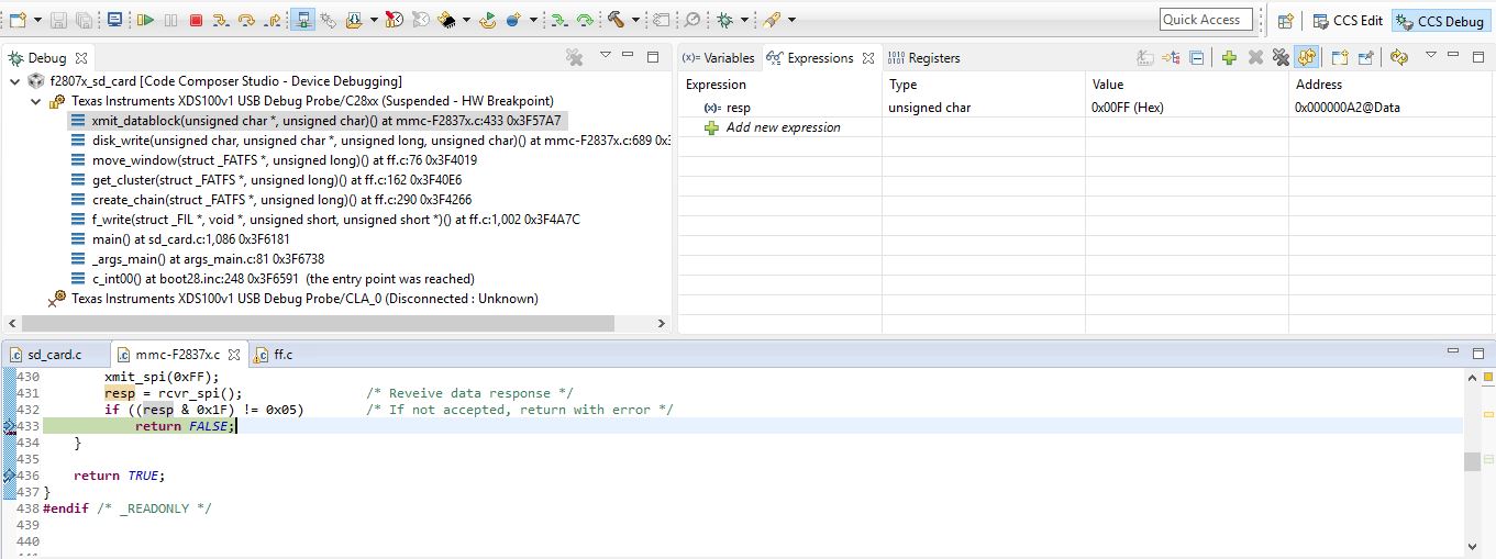

  • With what flags are you calling f_open? If you step through f_write, can you determine when exactly the error is received?

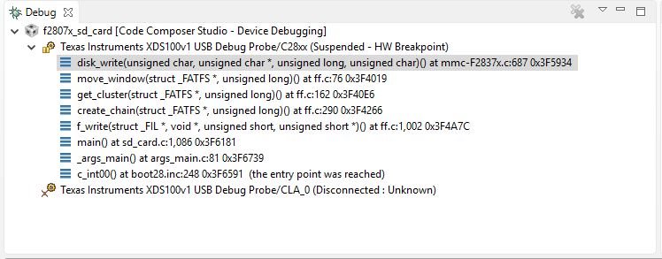

    By debuging I'm reaching:
    if (count == 1) /* Single block write */
    if ((send_cmd(CMD24, sector) == 0) /* WRITE_BLOCK */
    && xmit_datablock(buff, 0xFE))
    count = 0;
    in
    /* Write Sector(s) */
    #if _READONLY == 0
    DRESULT disk_write (
    BYTE drv, /* Physical drive nmuber (0) */
    const BYTE *buff, /* Pointer to the data to be written */
    DWORD sector, /* Start sector number (LBA) */
    BYTE count /* Sector count (1..255) */
    if (drv || !count) return RES_PARERR;
    if (Stat & STA_NOINIT) return RES_NOTRDY;
    if (Stat & STA_PROTECT) return RES_WRPRT;
    if (!(CardType & 4)) sector *= 512; /* Convert to byte address if needed */
    SELECT(); /* CS = L */
    count = 0;
    else /* Multiple block write */
    if (CardType & 2)
    send_cmd(CMD55, 0);
    send_cmd(CMD23, count); /* ACMD23 */
    if (send_cmd(CMD25, sector) == 0) /* WRITE_MULTIPLE_BLOCK */
    do
    if (!xmit_datablock(buff, 0xFC)) break;
    buff += 512;
    while (--count);
    if (!xmit_datablock(0, 0xFD)) /* STOP_TRAN token */
    count = 1;
    DESELECT(); /* CS = H */
    rcvr_spi(); /* Idle (Release DO) */
    return count ? RES_ERROR : RES_OK;
    #endif /* _READONLY */
    and
    the above condition fails. send_cmd() returns res= 0. xmit_datablock() returns FALSE.

    I have attached the image of debug window. Please suggest if I'm doing wrong.
  • Okay, I'm seeing a similar issue. For me, xmit_datablock() is returning false because the condition ((resp & 0x1F) != 0x05) is true (I think resp is 0xFF). Is that what you're seeing?
    Haven't had a chance to debug any further than that yet.
    Whitney
  • Sir,
    Sorry for the late reply. Yes as you have said
    I can also get the same response. I have attached image of debug window of the same issue.
    I have not used wait_ready(). Is the delay required?

    I have changed wc = 0 to wc = 256, but I'm getting cstat =1 in
    cstat = get_cluster(fs, ncl); /* Get the cluster status */
    if (cstat == 1) return 1; /* Any error occured */
    as move_window() within get_cluster() returns false
    if (sector) {
    if (disk_read(fs->drive, fs->win, sector, 1) != RES_OK)
    return FALSE;
  • Whitney Dewey said:
    I made the change suggested above (change wc = 0 to wc = 256) and it solved my problem.
    Sir,
    Which device are you using? I'm trying on F28069.
  • I've been doing my testing with an F2837xD controlCARD because it has a microSD card slot on it. I don't currently have an SD card breakout board so I haven't been able to test with the F28069. However, there are only minor differences between their SPI modules, none of which seem to be things that would effect the FatFS port.
    Whitney

  • Please can you tell me whether pull-ups resistor are required at MISO and CS?
    I have connected pins directly to the microSD card adapted from F28069 device, And at times the program does stuck at
    if (f_open(&g_sFileObject, "file.txt", FA_WRITE | FA_CREATE_ALWAYS) == FR_OK) { /* Create a file */
  • I don't know about CS, but everything I've read says you'll need one on MISO to avoid failures in the initialization process.
    Whitney
  • Sir,
    The Catalex microSD card adapter seems to be getting damaged when I'm using pull-up on MISO, and returns card not ready error and fails the file creation on the card f_open().
    As I said the program at times gets stuck at
    If I press the pins on the adapter then the above condition becomes true. I have attached the image of the adapter. I'm looking into it, please if you can suggest something, than it can be helpful.
  • Ravi,
    Were you able to resolve the issue? It sounds like there may be a hardware problem, as physically pressing on the pins seems to affect the performance. If you have a magnifying glass or microscope and soldering iron available, investigate the SD Card board for poor solder connections.
    If you are still experiencing an issue, please let us know.
