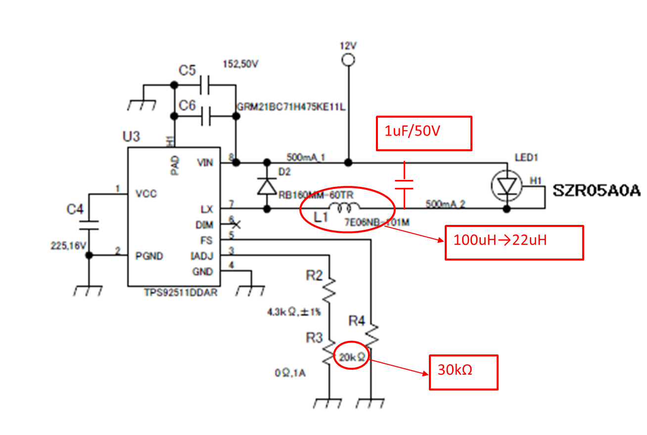

We have following design requirement.
VIN:12V
VLED: 2.2V
RFS:3.3K
RIADJ : 4.3K (0.35A as led current)
L : 200uH
These specification will offer Iripple = 0.029App that would be 8% for led current.
Actually, a design with these parameters did not work. (LED current does not reach required 0.35A)
Is there possible that the LED current is not flowed if ripple current is small?
Are there any recommendation of current ripple?
