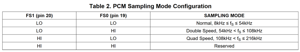

I need to support the following sample frequencies, can I use it with this device?
・ 5.12KHz
・ 6.5536KHz
・ 8.192KHz
・ 10.24KHz
・ 12.8KHz
・ 20.48KHz
・ 25.6KHz
・ 26.2144KHz
・ 32.768KHz
・ 40.96KHz
・ 51.2KHz
・ 81.92KHz
・ 102.4KHz
