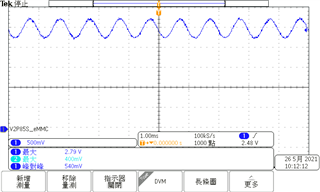

Hello Sir:
We are using single end input.
and we try to modify R459 to 7.5K, R460 and R461 to 15K.
But we heard the sound has no change.
Can you please help us to check the schematic? is it right?
And please let us know the maximum gain of TPA6204A1.
