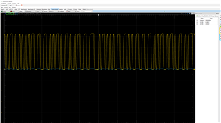

  • Hi  - here is the waveform you requested
    Yellow is the output from my ADAU1452 and blue is what the PCM2906 is outputting on SPDIF.  Both probed at pins 1 and 3 of CN002
  • Also I just verified if I reverse the direction of audio I can  send audio from my PC -> PCM2906C EVM -> ADAU1452 EVM via SPDIF (pin 1 on CN002), and  I can successfully monitor the signal with the on-board headphone output of the ADAU1452 EVM.  I'm not sure why i'm getting no output whatsoever when trying to get SPDIF into the PCM2906C with a seemingly valid waveform

  • BTW just figured out the problem.  I noticed the status 11 bit was set to 33280 for some reason, and when I set that on the transmit, that seemed to do the trick, whatever that encoding means. Also I needed to set the audio word length to 24 bit despite the recommendation for 16 bit - I guess there are padding bits that are not used
