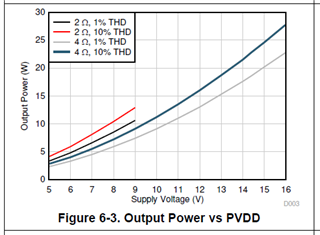

Q1. In figure 6-3, there is no graph more than 9V at 2Ω. Does it mean we can't input more than 9V when using 2Ω load?

    Q1: when PVDD is above 9V for 2ohm load, it can never reach 1% THD, because OC will be trigged.  So in the application of >9V and 2ohm load, the input audio level should be limited to avoid output OC.
