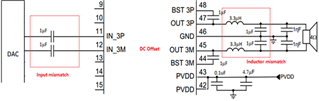

  • Hi Cherry,
    Q1, do you mean pop noise when power up/off? The pop noise is mainly related to mismatch of audio input and output.
    Q2, I can not fully understand. what the effective solution on the hardware means?
    Q3, No. that is fine.
    Derek

  • Hi Cherry,
    The pop noise is from the mis-match of OUTP_N.
    –Input mismatch
    –DC offset.
    –Inductor/layout mismatch
    I suggest the power sequence:
    1. Amp is disabled
    2. Initialize DAC.
    3. Enable Amp (SDZ high).
    4. Mute AMP.
    5. Begin audio out from DAC.
    6. Un-mute AMP.
    1. When Enable Amp (SDZ High)-------- Mute Amplifier first, Then SDZ High, Delay >40ms then Unmute Amplifier.
    2. Add a delay (>20ms) to ‘Finish Initialize DAC’ and ‘Enable Amp (SDZ high)’.
    Derek

  • Hi Cherry,
    Yes. The main reason is the audio input DC caps mismatch. So the suggestion above is for this. Waiting device power up successfully, then unmute output.
    Derek
