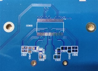

TPA3255-Q1: TPA3255-Q1 output power can't reach 480W
Part Number: TPA3255-Q1
Hi TI customer,
