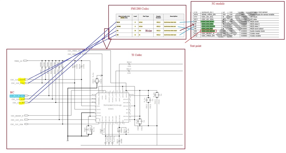

The customer evaluate to use TLV320AIC3109EVM-K to replace FM1288 Codec, but they only reserve four lines of I2S signal (no I2S_MCLK) .
Is it OK if the MCLK TI Codec is not connected?

You can use either MCLK or BCLK, so if you can't provide MCLK then use BCLK in your configuration.
